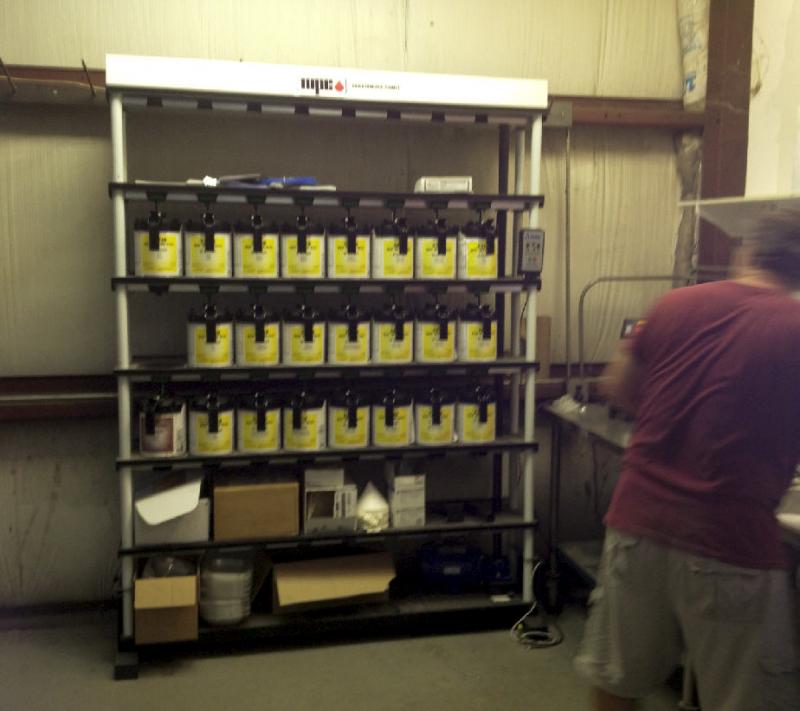

Could you or SignManiac post a picture of the system? In the bodyshop
we had a mixing bank with (guessing) 80-85 mixing colors always stirring.
That was basecoat of course. Thanks Gene
SignManiac
The top two shelves are the primary base mixing colors. The bottom row is all of the metallic mixing bases. My setup has a manual mixing timer that turns off after 15 minutes. You only need to hit it once in the morn, again mid afternoon, and before you leave for the day. Your colors are mixed by weight and the scale is incredibly sensitive.
You only have about 20 gallons on the shelf to mix everything. They even have a pearl additive for flip flop colors and an assortment of clears.
