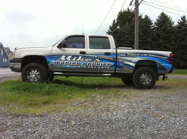

We generally remove everything we can, including flares. The truck below is the same body style with the same fenders. We removed them, wrapped the bedside, reinstalled them and then printed patches for the actual flares. More work? Yes, but it looks better, there''s no paint showing around the edge of the flare and it will last longer.
Thank you, how far under the flair did you wrap?
Nice install job, but.. i cant read 1 word in that design
kstompaint
Not sure this thread was about design, but...
The customer worked with us to refine the design. We initially had it more commercial looking. It doubles as his personal vehicle and he was "more concerned about it looking cool than being readable" so we went with more of a custom painted look. Also, the pic I took with my cell phone kinda sucks.
