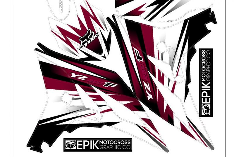

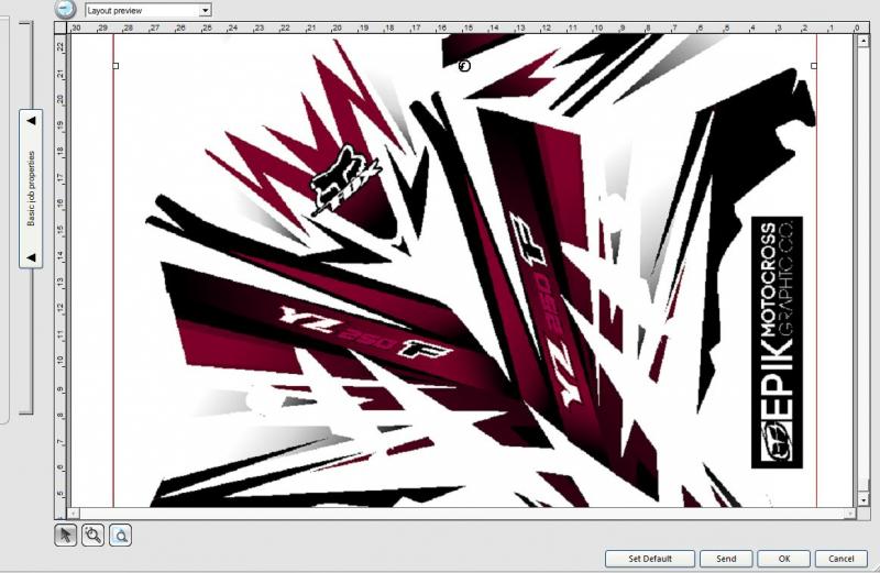

Update, I was wrong. You can infact see the gradiant issue in the production manager view before sending the print. I have attached 2 more pics, the first shows the graphic in flexi before sending to production manager, the second is the view from PM
view from flexi
view from production manager
