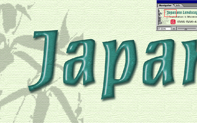

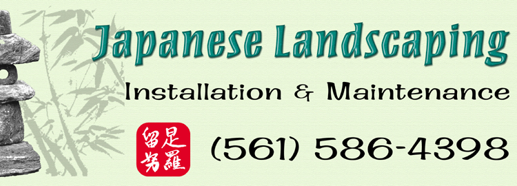

    Attached is a sign I'm printing while posting this that was totally setup in PS 6. The top line was given a PS Style Palette treatment reminiscent of jade. The Edge print came out gorgeous.

    That looks great Fred, I am wanting to do art similar to that.
