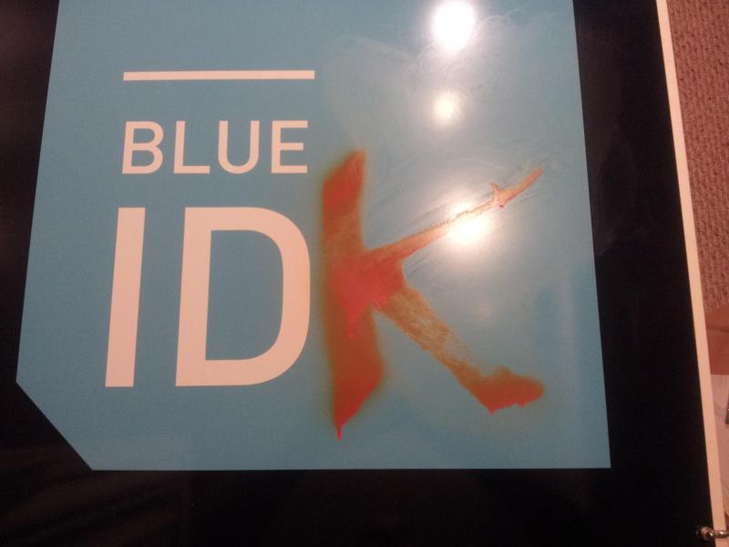

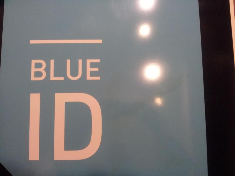

here r the before and after pics
i used good ole rapid remover and cleaned with rapid tac still has a little ghosting but it's gone
