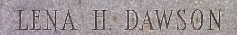

Font for granite monument
zmatalucci
Anybody have a clue on what font this is?
PLEASE HELP:)
Fred Weiss
Merchant Member
No match in my database. I also compared it to the monument fonts from Gerber and nothing matched there either.

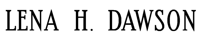

If you're looking for similar, Gerber's Monument Modified Roman Condensed.

zmatalucci
Thanks fred! I have that font as a tt, so I'll probably print the info on vinyl and apply it to the mask, then cut it out by hand and add the points to the serifs manually :)
James Burke
Zeth,
I'm with Fred. That's condensed modified roman with wedge serifs...and obviously hand cut. You should be able to to plotter cut and hand tweak the serifs with an x-acto knife.
When blasting, those tight serifs can be a real pain to obtain any definition without over blasting the letter itself. I like to focus on the serifs first and then work my way back into the lettering.
I just did a date cutting last year that was a condensed modified roman sanserif. I ended up using SignLab's font editor to generate a totally new font. Actually, it looks quite appealing.
Stencil cutters (the people kind) took a lot of liberty back in those days and you never know what you'll find especially with an "at need" stone. (Where they didn't worry about having to match fonts for a later date cutting)
