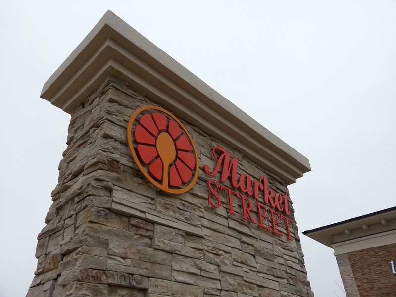

I'm having to install the letters shown in the attached photo to the stone-faced monuments. Each letter has 3 or 4 studs, so I have to drill a 3/16" hole for each stud. There are 6 sets of these letters altogether, so when drilling that many holes, my mind always wanders to whether or not I'm using the best tool for the job.
I currently have a bunch of the DeWalt 20v stuff including the SDS rotary hammer which works great and is what I use for installs like the above one. I'm always reading up on new tools, specs, etc. though just to see how everything compares. So I figured this morning while I'm laid up sick, I would compare the various cordless SDS rotary hammers.
Milwaukee kills it in IPM and RPM but the Impact Energy is significantly lower than everything else. So that makes me wonder if there is a perfect combination of IPM, RPM and Impact Energy when it comes to rotary hammers or.......? It really makes me wonder how these would shake out in a head-to-head comparison. Take all the tools listed below, use the same brand bit in each, and drill twenty ¼" holes then twenty ½" holes....who wins?

Aside from the tools when i drill in stone or concrete i always go in with a very small bit (diameter) it holds the point better and is not so invasive as a larger bit. I then drill with the bit required for the stud. I use nothing but BOSCH DRILL BITS. They are the absolute best I have used. Milwakuu, dewalt, B&D, all of those suck. The blue one are the best

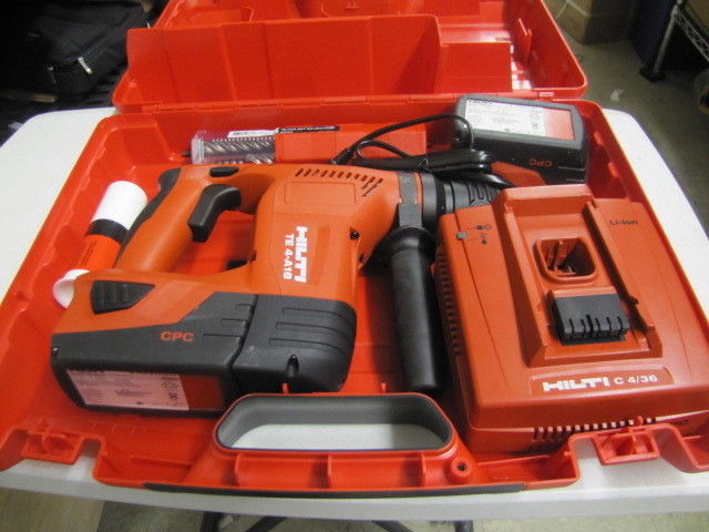

Well, quick update on this. I came across this comparison which is exactly what I was looking for: click
Given the wide range of specs, they didn't pan out the way I thought they would which makes me think there's some research behind these rather than just producing a tool with the highest specs.
Anyway, picked up the Hilti TE 4-A18 they used in the tests. Looking forward to seeing how it stacks up against the DeWalt. According to the tests, the Hilti blows it out of the water.
