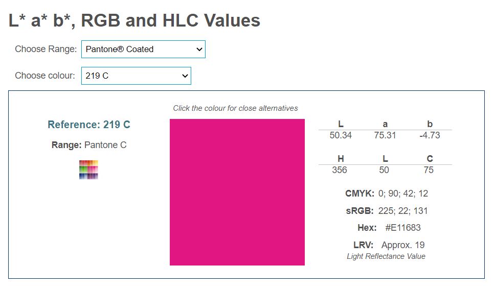

just browsing another site that lists CMYK and LAB from pantones ( https://www.e-paint.co.uk/Lab_values.asp )
Lets take
7479 C green as an example. Note: I have not printed this color, so maybe my device values are way off.
7479C
CMYK - 100,0,39,19
LAB: 73.34 , -58.61, 27.63
Now if I goto pantone books in onyx...
7479C:
Device values: 73.3, 0, 83.9, 0 - Quite a bit different, and nowhere near what values the site says
so If I started with what the site says, I'd be pretty far off.... whereas if I took the LAB value and put it in, I'd be pretty close.
CMYK Values mean nothing to me for color matching... I always use LAB and then tweak by eye if I need to. Maybe I'm doing it wrong, or ineficiently... But color seems to be subjective anyways. And most of the time when someone gives a pantone, theyre basing it on the pretty, over satured monitor color and cant understand why when you pull a pantone book out and show them it's a perfect match, you cant match what their monitor at home showed them.
The Lab values are not far off. They tell you to use the sRGB color space which is necessary to know. They don't tell you, however, the CMYK color space. I can tell by comparing the CMYK numbers that the press is not at all calibrated to gray and has a severe Cyan bias which the profile is compensating for, and it's too light. The value of the CMYK readout is to only avoid that press.
