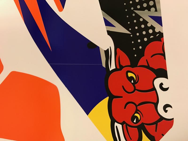

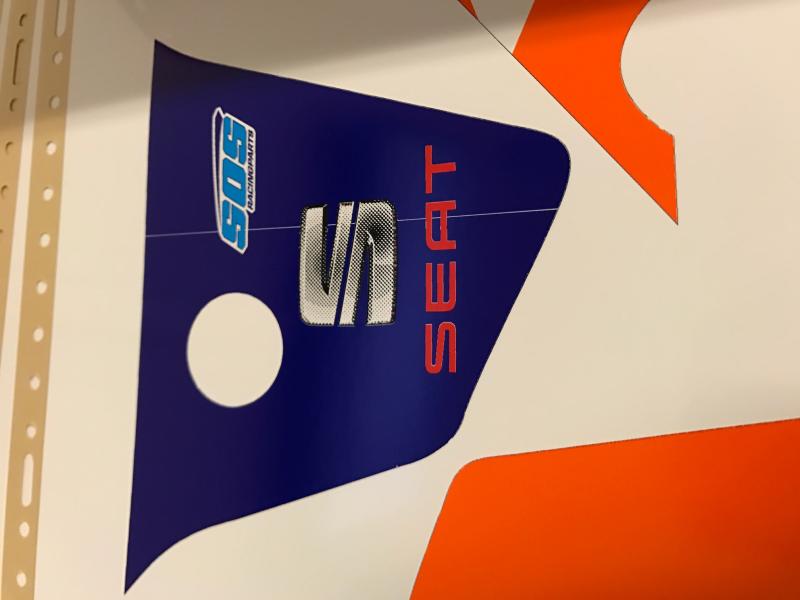

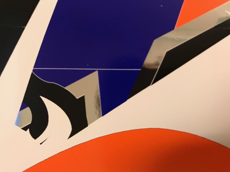

We got a Gerber Edge 2 running and it make these really annoying white lines pretty much on every single print. Its random if its only a few or more but it ruins some of the print each time.
Its not one specific color og ribbon. has any of you guys tried this?

Since, from your photos, it only appears to be happening with the dark blue foil, it points to either the foil being defective or the cartridge may be jamming a bit. As a test, try switching a different foil in for the dark blue and see if you still get the dropout.

we´ve tried that already unfortunately.
Its like it stops once in a while to buffer, and then it resumes, just for a very short while. and whenever that happens it makes a line.
I have no idea why it stop to think/buffer!

The pausing to buffer is just that and it is normal as the Edge reaches back to download more data. The lines are not normal and could be the result of lots of things ... many of which are very expensive to repair. My usual approach is to try to narrow down to whether it is the foil, the vinyl, external cables or something in the Edge itself.

Thanks for all of your responses.
Browner, what do you mean by "Print head Data Cable"?
we have ruled out the Vinyl and foil ribbons as the problem so far

It is due to "blown pixels" in your Printhead. The blown pixel creates a void rendering the foil color unable to thermally bond to the vinyl under the place where the pixel is blown or no good.
Right now I am getting quotes on replacing the Printhead from Gerber: $2500.00 for the part, $220.00 an hour for labor and travel. You could have them come to you and pay for travel or crate the behemoth up and send it to CT.

Fred is on the right track with his initial suggestion.
Not a blown pixel or damaged print head as your other foils are laying down properly along the same axis (you would see the same line continue in other prints).
Although possible, I am skeptical that this is a damaged printhead data cable as you typically you would see a missing zone rather than a single line. Could be a buffering issue caused by a failing communication still elsewhere though, maybe the mainboard? If you can disable foil conservation this may circumvent the issue but you will blow through your blue cart.
Check your cartridge for how much is consumed. Sometimes when 75% of a cartridge is used up the foil can bind after larger prints due to friction or mechanical failure (clutches, motor, power supply) affecting the foil drive mechanism; however, if this is consistently in the same spot on every print it indicates a communication issue.

We will try disable the foil conservation, but we will only use it for a few more days before we pack it up and put it on ebay :)
the issue is pretty much only on the chrome, metallic foils and we have tried changeing casette.
