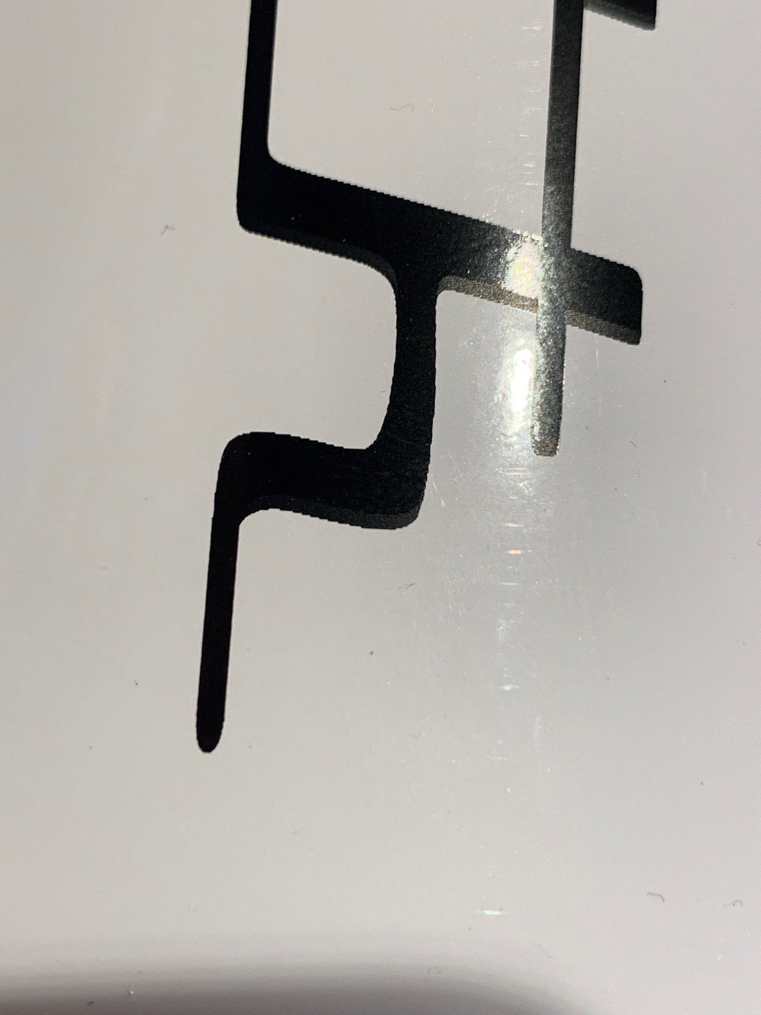

Hi all, I managed to make it print after buying and old computer with a paralell port. It worked straight away thanks all!
now I have too issues:
  1. first is the band that you can see in the prints? what can it be?
  2. I still have several white spots while printing. They appear randomly and I made sure that there was no dust...pretty frustrating
Thanks for the support

Print on cast vinyl- white spots are usually from calendared vinyl. And use Gerber foils and 3M or 220 scotchcal vinyl.
Sorry what do you mean? I have discovered that indeed it only happens in my Imageperfect white Vinyl. in the transparent vinyl it works well.
