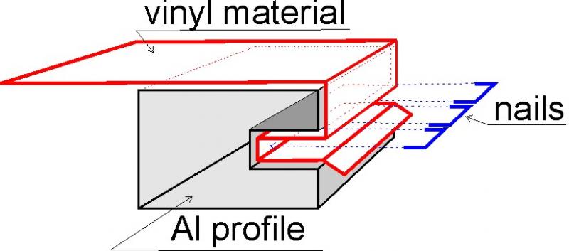

hi,
do you know, how strong nail gun ( air, electrical ) is good
enough, to come through Al profiles.
need it for vinyl light sign .
thanks alot for your tips.

I would think self-tapping screws would be better . . . or Staples of some sort !

hi,
thanks! you´re right.
i wrote nails, but i mean stamples of course.
sorry for my mistake.
Replicator
well, staples are still not self tapping screws...haveta be a pretty rugged staple to pierce aluminum i would think...
You'd be surprised how easily a good staple gun will shoot stapled through 040 aluminum. any thicker and I would go self tapping myself.

Looks to me like your profile system is designed to make use of a slide insert which should have the fabric stapled to it.
I can't really understand why you want to whack the fabric straight onto the aluminium? How are you going to adjust the tension? What happens if you get a wrinkle in the face? How do you get it out?
Most flexface systems I've used have an insert system coupled with spring loaded or ratchet tension devices.

We have a stanley bostich stapler and it works just fine for the milliken extrusion with cooley or sunbrella. The tip of the nailer fits right into the channel in the extrusion. We also have a palm nailer that my guys modded to hammer in the rubber trim. Haven't done one in a good while, but once you get going, covering these things is a snap.
