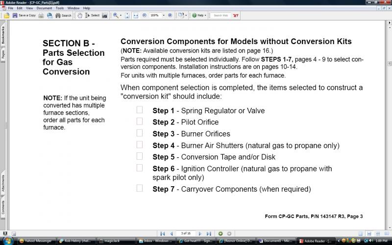

Old Paint, in the conversion kit besides the orifices, I believe there should have been a light weight spring you need to install in the gas valve.

brad, yes there was a spring that goes into that silver regulator/pilot lite mechanism on the under the fan. replaced it 1st. no need to worry bout the adjustment on it as the propane tank regulator limits the out flow at 10 psi max. as for the the fresh air duct for the flame, i already said i was gona make a plenum to introduce fresh outside air to the flame area and it will be hung from the roof at 8-9 ft from the floor. as for the pilot, it has a sensor the flame keeps at a certain temp, sorta looks like an O2 sensor thats on your car. if the sensor doesn't get proper temp, it shuts off the flow of propane.

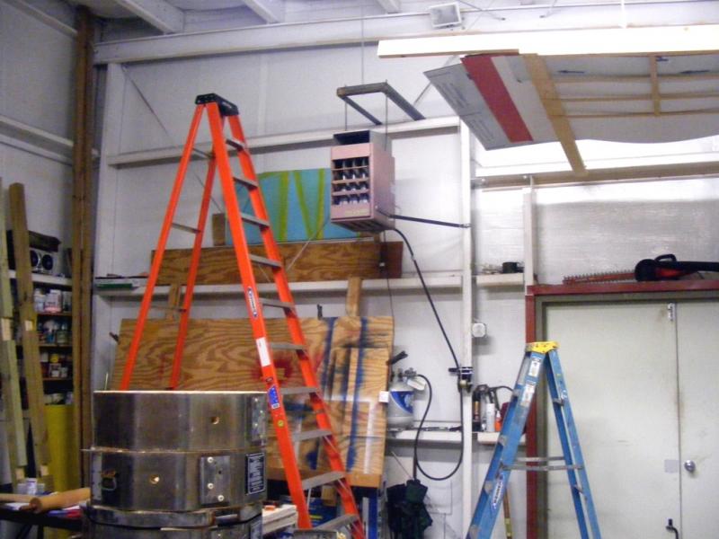

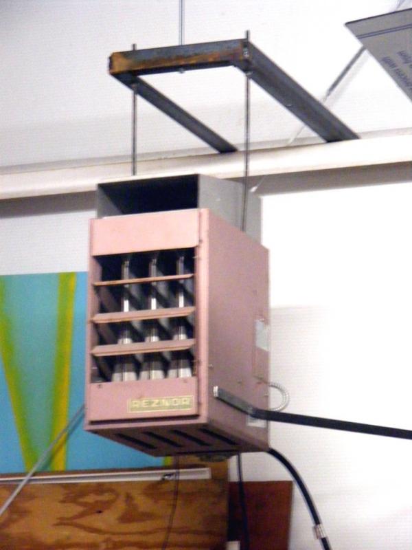

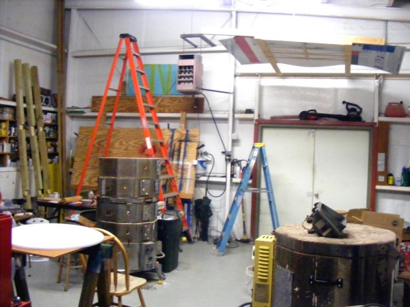

UPDATE: got it hung this weekend. need to put in permanent gas line to outside when i get the 40 lb tank. i welded the angle frame, drilled the girt and purlin to secure the frame. have the bottom of the heater at 8 1/2 feet from floor. wired a new dedicated 110v receptical, need to run the thermostat wire bout half way in the shop. will add chimney pipe now that its in place.

OP, unless it's too late....... that kinda heater does much better when you aim it from corner to opposite corner and you usually aim it at the north/northeast side. You want the heat to circulate rather than hit a wall head on and the reason for pointing northerly is to heat up your coldest wall. You lose less BTU's this way.
OldPaint
shop is 24 wide x 30 long. and iam going to put in a ceiling fan almost in the center of it. heater is mounted on the west wall. south facing wall has 4'x12' of polycarb clear panels that let sun and light in. north wall has the 10'x12' overhead insulated door.
