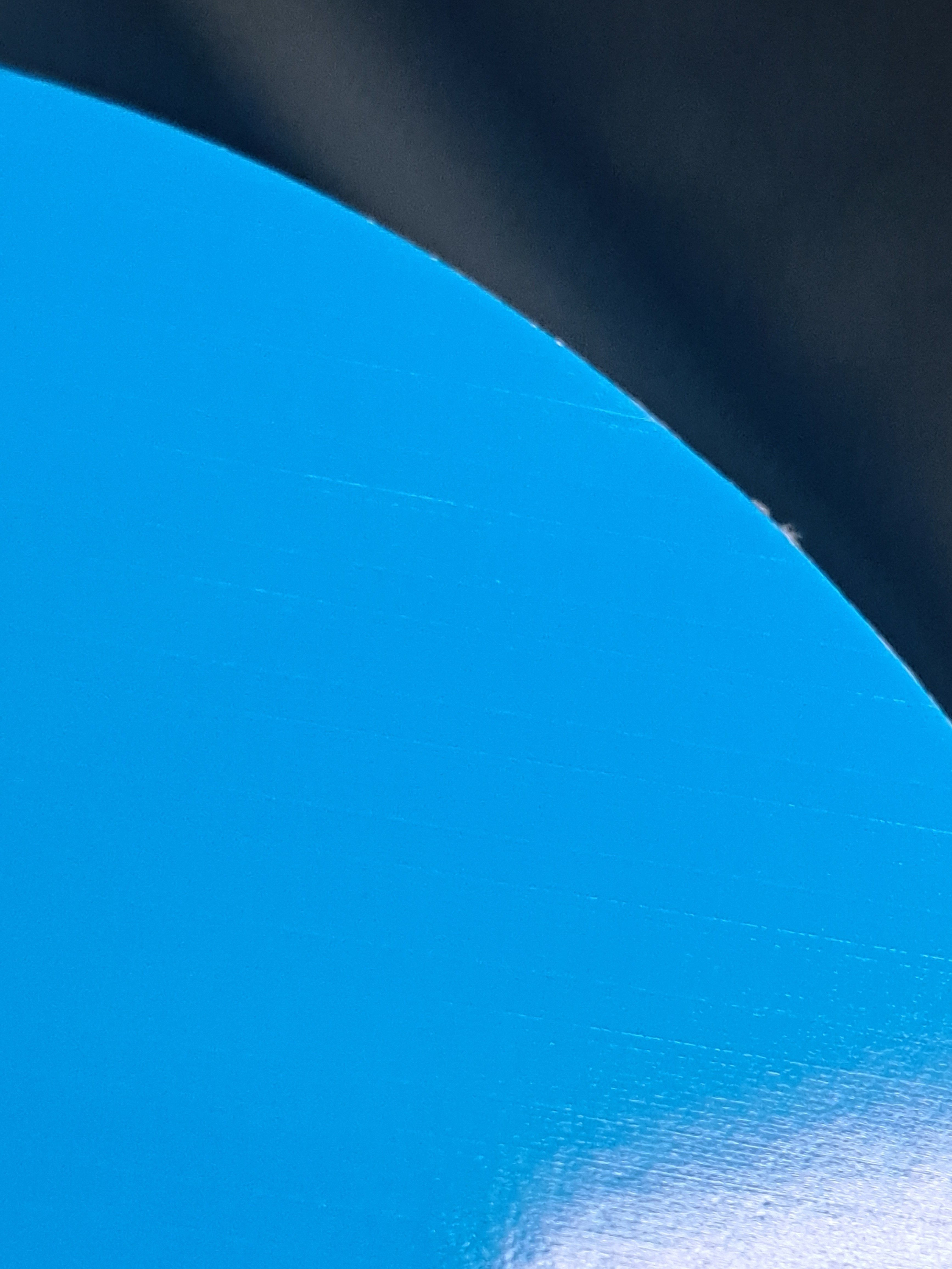

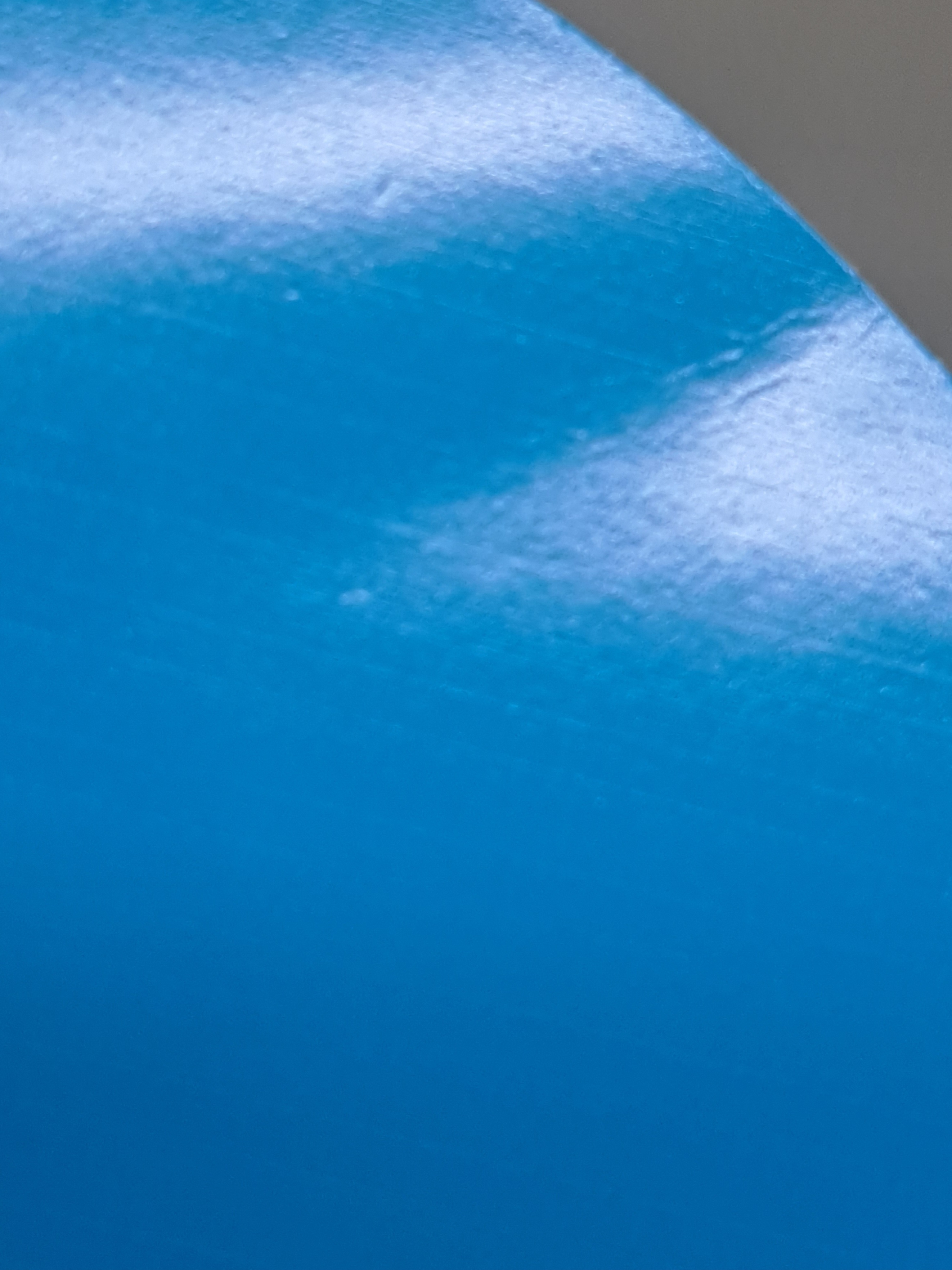

See the attached images as samples for reference...

The SG are notorious for producing grainy solids in lighter tones, because they have no light colors. In addition, the TR-2 is higher pigmented, than earlier inks. This means, less but darker dots are printed to achieve a desired color.
From what I can on your pictures, the dark red looks like beading or pooling to me. This is a material/heating/printspeed problem.
On one photo, I think I see unsharp edges of the patches. This is normally a bad M-Gap adjustment.
Then, there is one thing, that is very annoying...
Roland thinks the two channels on printheads fire at the same speed, so only one channel needs to be adjusted. (This was their misconception starting with Epson and they do it with Ricoh as well)
When adjusting SG's (VG's as well) the CM head is sometimes so badly off, it needs replacement. Otherwise, you will never get a decent quality.

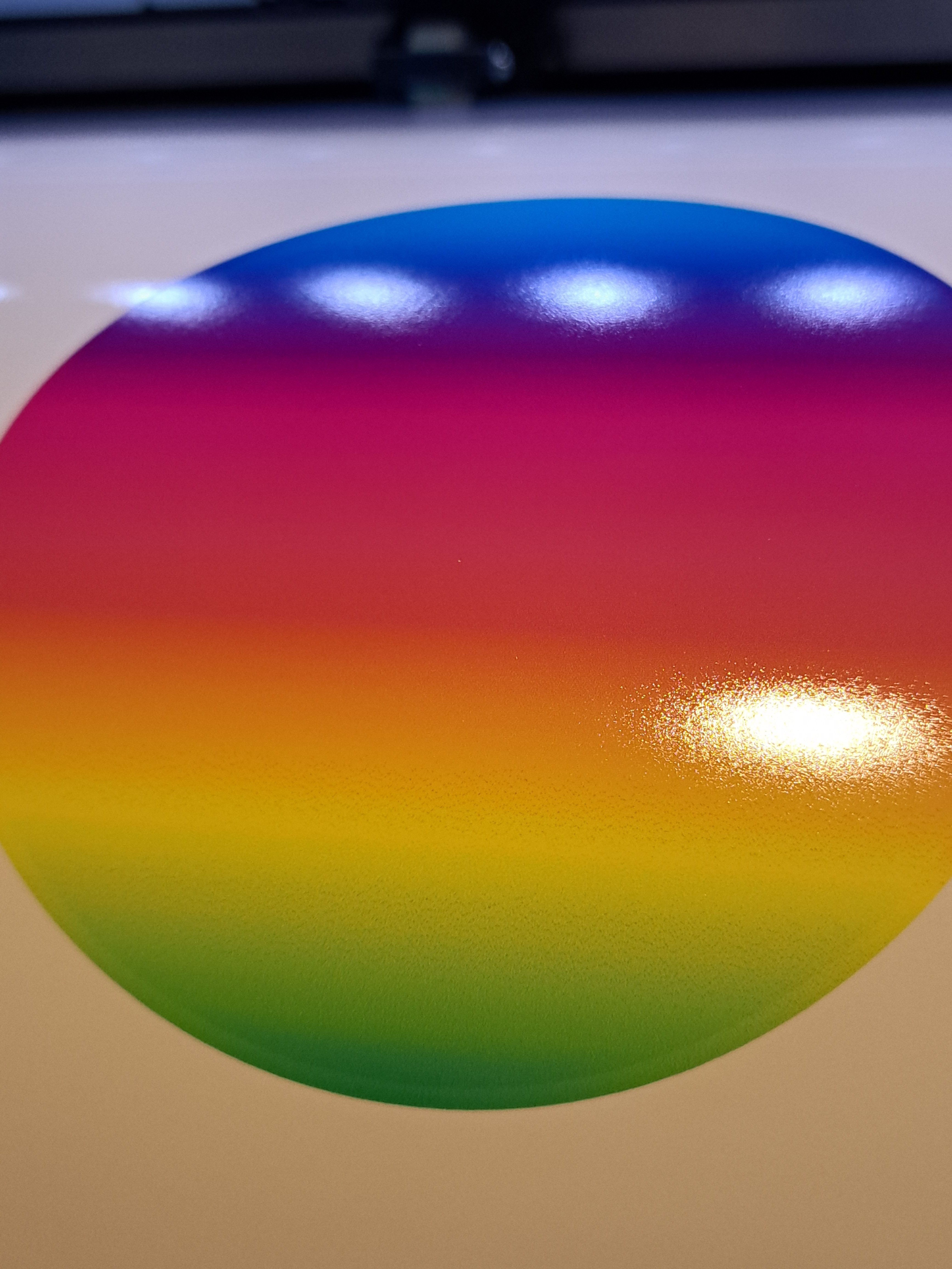

most colours seem to work nicely now after doing a fill thing using pause and power... its just the yellow and orange blend has dark dots, is this normal?
damonCA21
That can be normal with orange and green tones as these are the hardest for the printer to reproduce. it may also be how the gradient fill on the artwork was made. For example in Corel with a gradient fill you can choose between 256 and 999 bands for the quality
I just use illustrator and set up a gradient from swatches. Will look into that.
