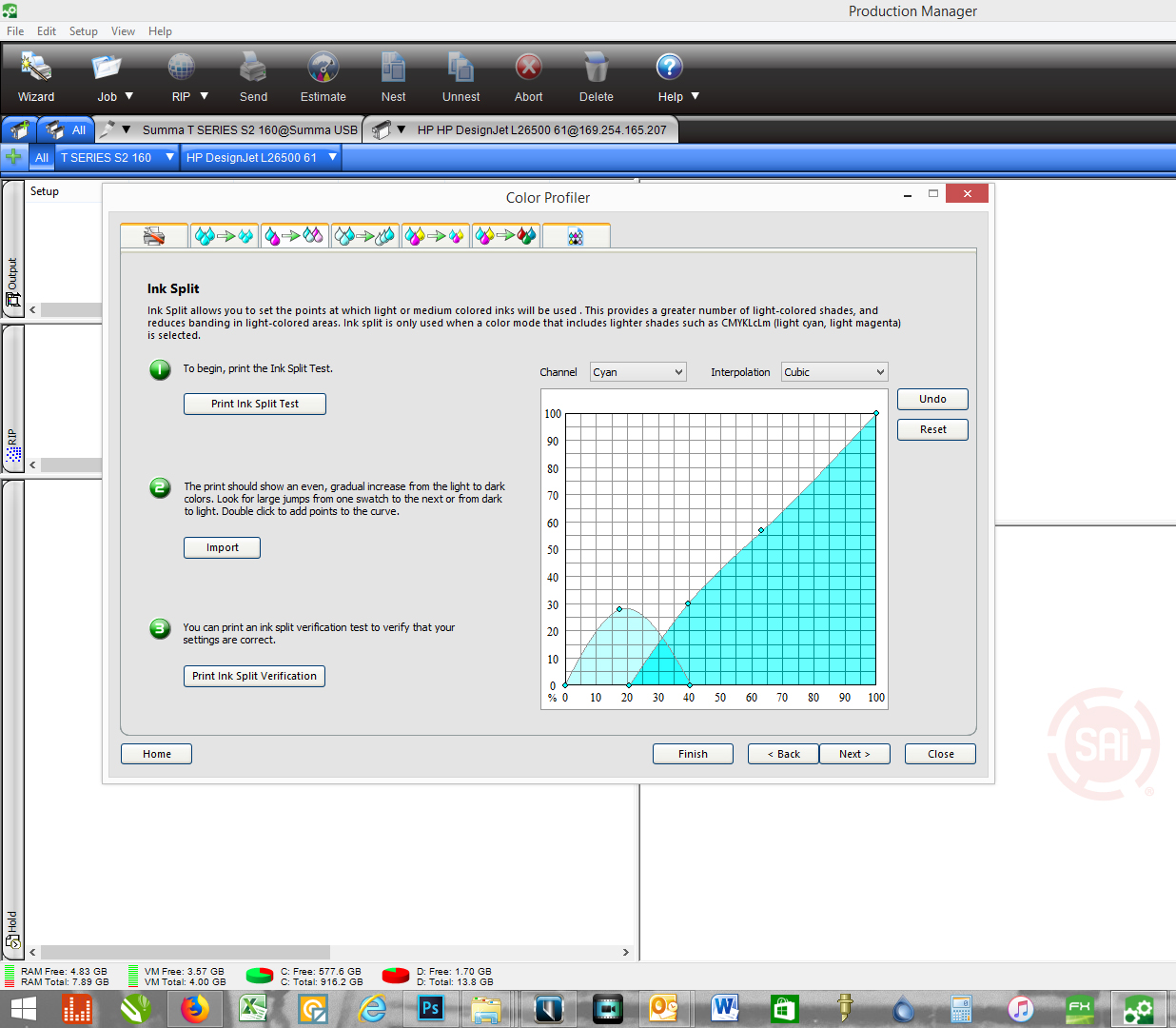

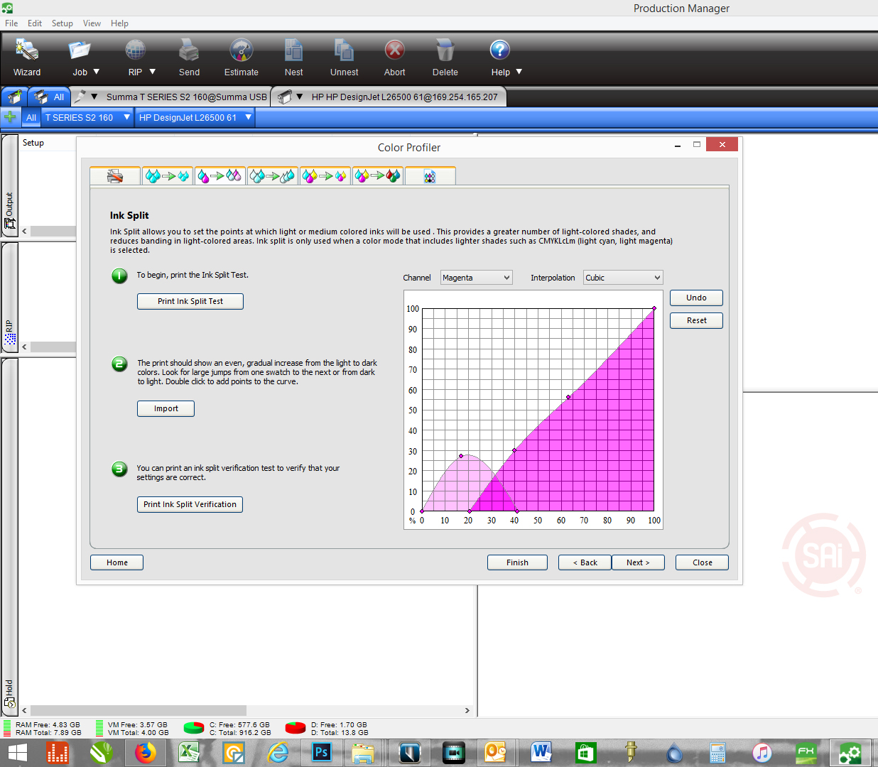

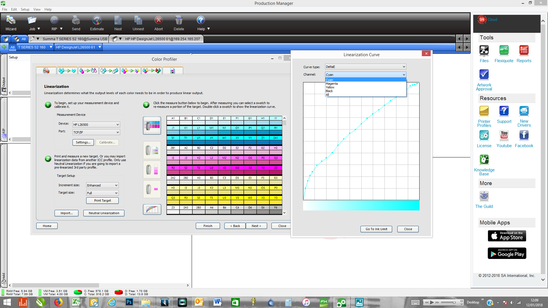

This is an image of the Linearization curve for the ICC profile i use mainly. From the drop down it doesnt show LC or LM options. There is the ink splits screen options and I have attached these also.

I thought you were using ONYX. But anyway that is pretty minimal light ink usage but I don't know the results with Flexi. RIPs are not all the same with what will appear to be the same settings producing different results with different RIPs. But for low graininess you typical want get the high point for the light inks in the 50% range and the cutoff in the 75% range. And then the black start in the output profile should be 25 or 30. Make a new Linearization and Output Profile with these settings and see how your graininess looks. I can't remember what the pass counts were on the 1st and 2nd generation Latex printers but you will want to use a higher pass setting to allow more ink lay-down and is does have a less graininess look to some degree.
Keep in mind your printers dot size in is much larger that say a aqueous Epson for Canon so some graininess will always be there.

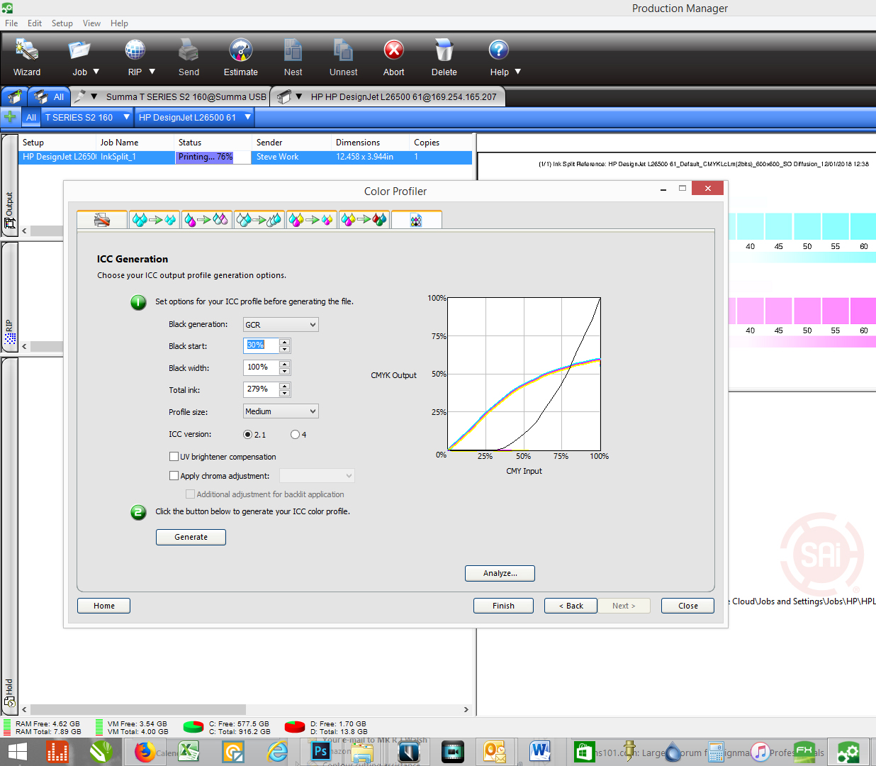

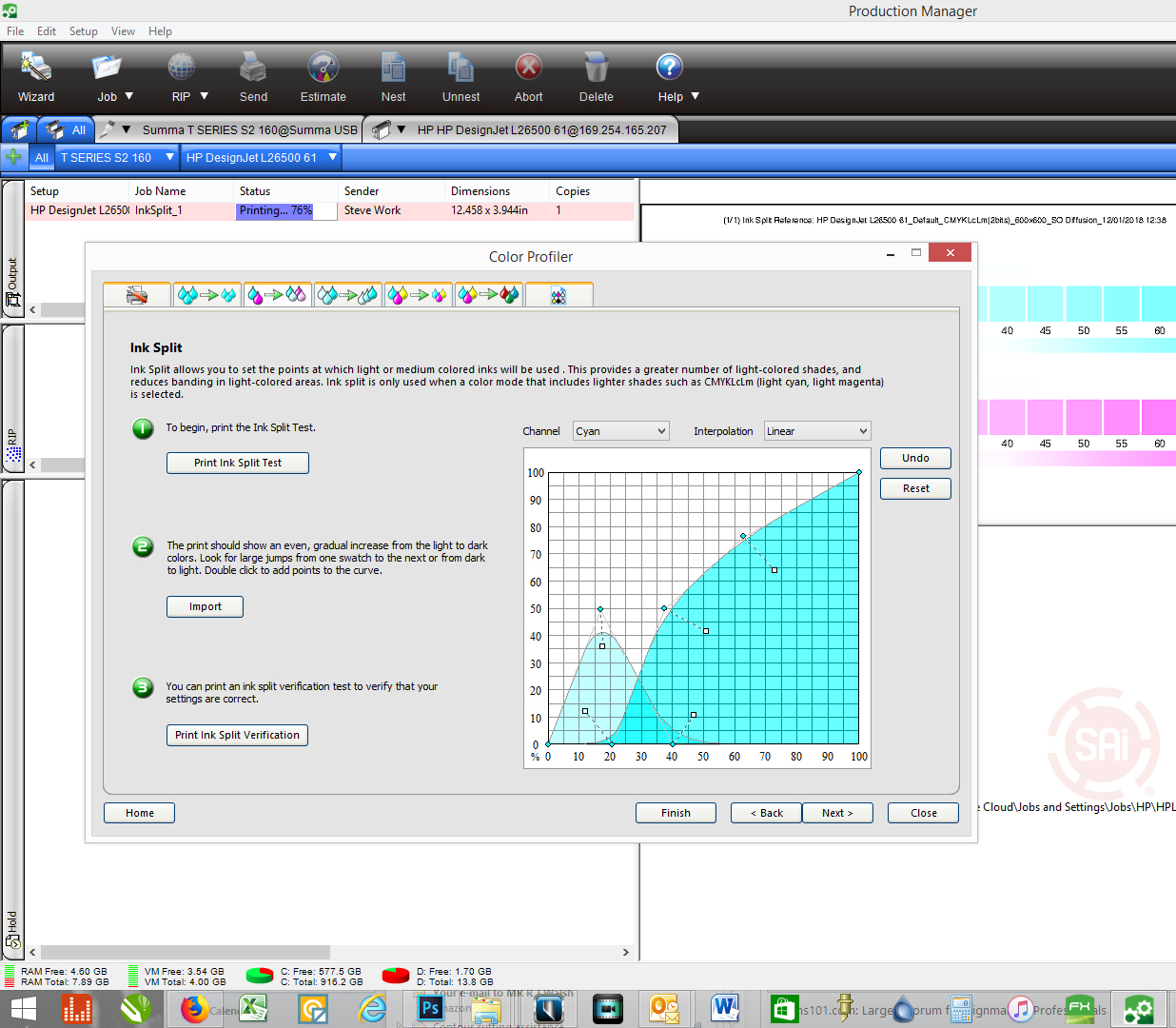

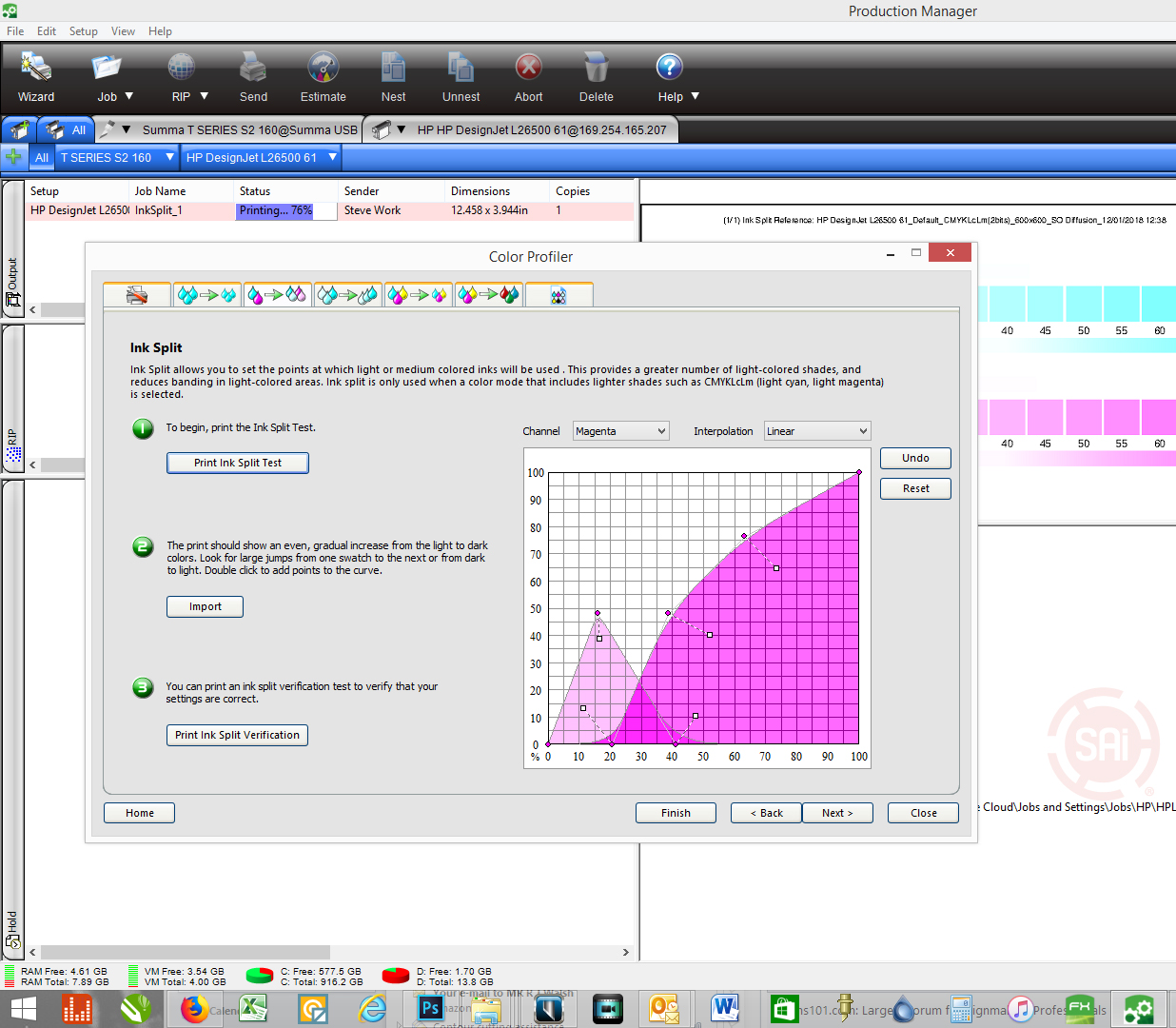

Have I done this right? I have increased the values so the Cyan and Magenta ink splits are from 50% to 75%. In the ICC generation I selected GCR from the drop down and set it to 30%. It was at 0%
I probably haven't do the cyan and magenta right, if not can you explain a little what I should be doing.

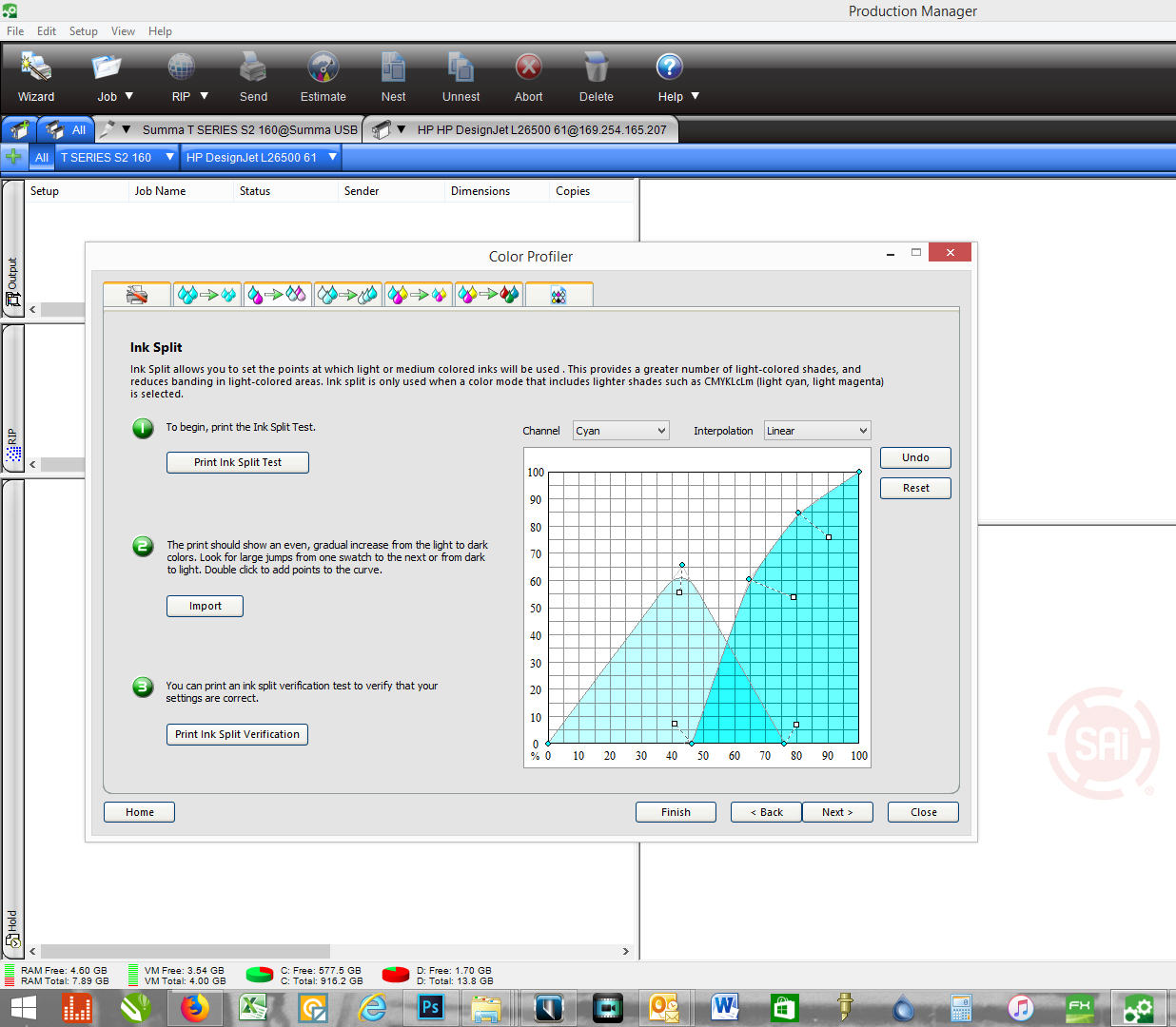

Or is this one more inline with what you mean
Yes but 60% is to high. Try 50%. What you will be fighting with raising the light ink high is laying down too much ink. The media might be less accepting of that much ink and your pass counts, inter-pass delay, and heat will have to be high enough to properly cure the ink. You just have to test it.
Steve Shaw
I have just got off a Teamviewer meeting with Sai Flexi support and we have gone through a profile and changed the Ink limits, Multi-Ink limits, The GCRsmooth , the light ink curves. Just testing it all now, he showed me how to keep tweaking it to make small adjustments and keep testing till I have a decent profile. Ill keep you updated. thanks again
