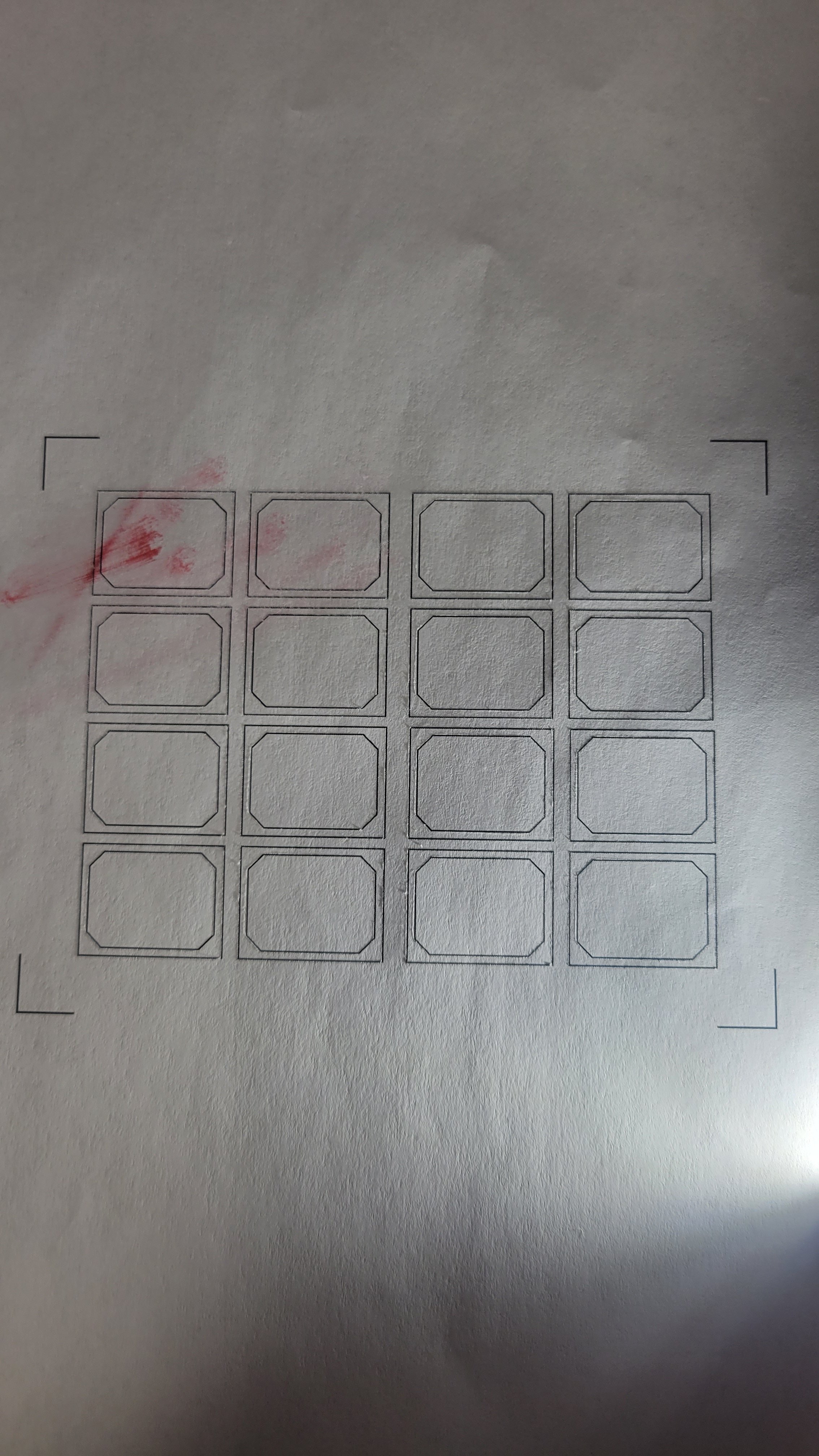

Graphtec FC9000, not able to cut a 0.75" long octagon,
gpslitt
For the Blade start point, i keep at y axis start, which straight the blade to start, thats y first line is always straight, problem starts when it takes first angle.
I tried vinyl, laminated vinyl and normal printer paper A4 doesn't change the result. yes clockwise

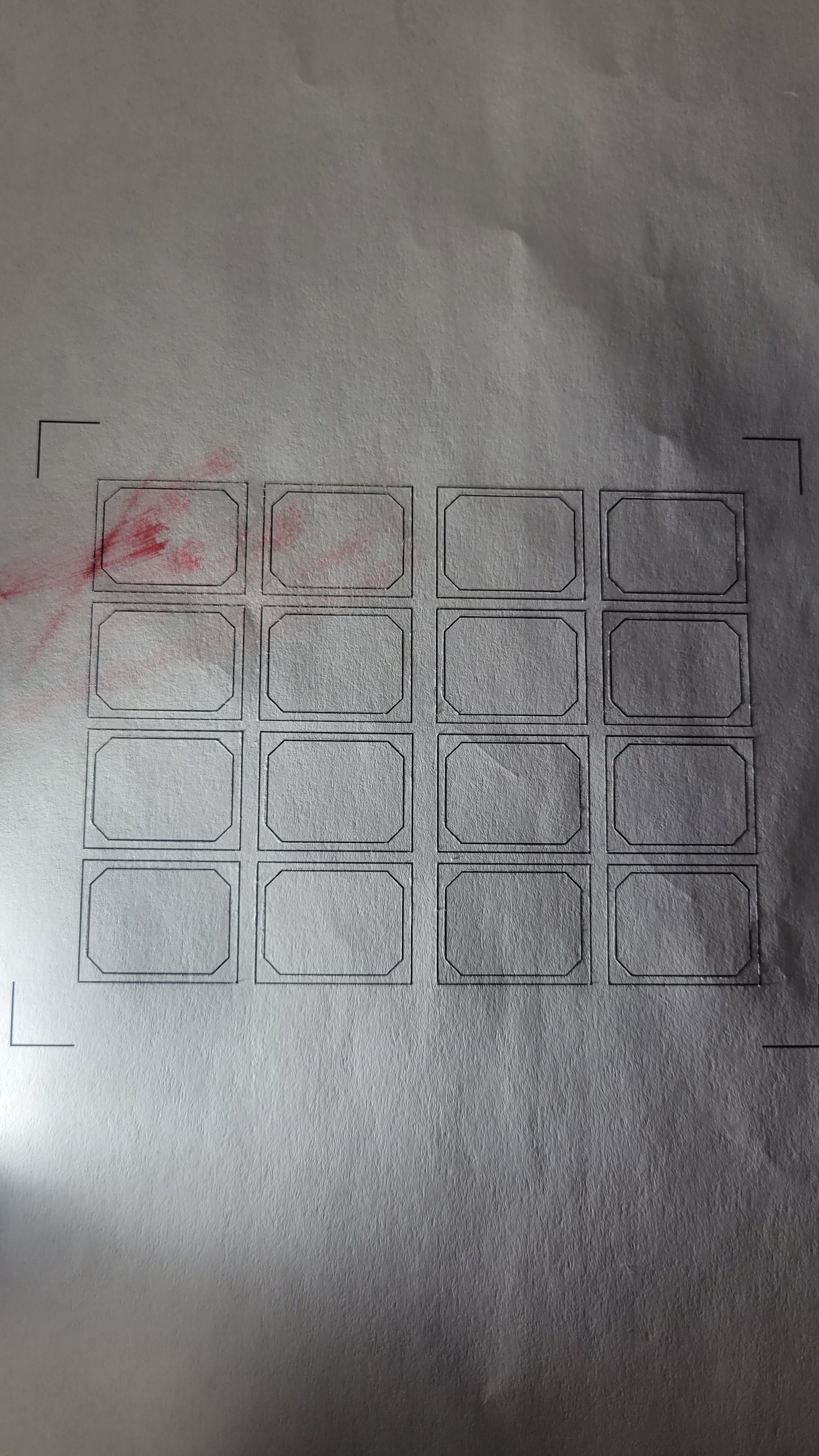

gpslitt
I printed 4x4 grid and the problem remains.
sorry for red color spill, i tried to fill the cuts with red color to be more visible, didn't worked
dypinc
Just to add I am printing these shapes with shape stroke 0.5 pt.
Were you able to try a different blade holder. Something seems loose or blade is binding. Also try just cutting that shape on vinyl without registration marks. No need to print just to see if it will cut straight.

dypinc
I went back and looked at the last photos you posted. Looks like the blade is set to deep and possibly the force as well. I would put some unprinted vinyl in and cut the shape starting with setting the force depth without the blade protruding and lower the blade in small increments (like 1/8 turns) until you can see a cut. Will it do it at the first sign of a cut?
