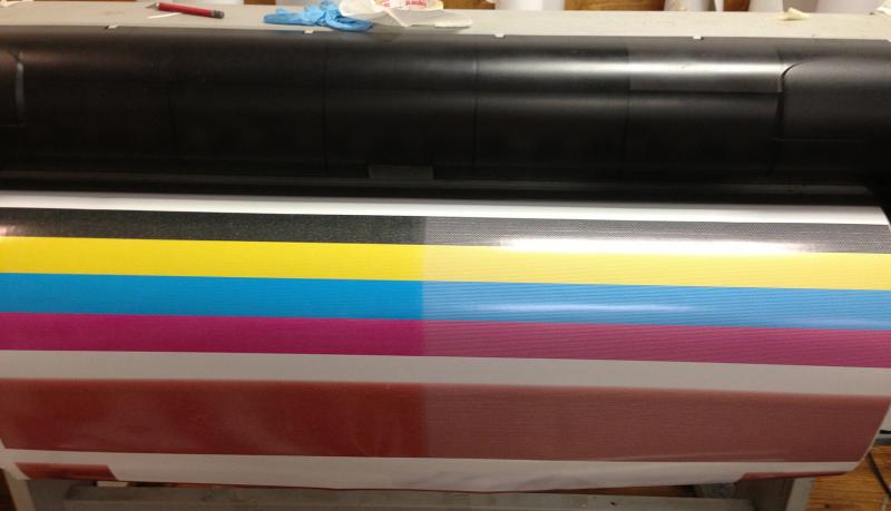

thats odd.
might be a kink etc in the cables that run along the belt from MB to head, only getting kinked once carriage is halfway out?
Is it dry completely across ??
Could it be the heater isn't working on one half or are all of your other medias working fine ??
thats odd.
Looked for kinks starting with wire going to machine & found problem right away!You rockLooked for kinks starting with wire going to machine & found problem right away!
