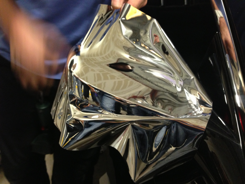

Just took a class with justin patr, awesome! Avery wrap is the best of all them, he suggested to laminate with 1460.

Thats really shiny I got 2 rolls of this stuff coming im going to try it if i don't like it ill buy the Avery.
ironchef
Its awesome, just becareful not to over stretch, and laminate with optically clear CAST lam to prevent scratches
