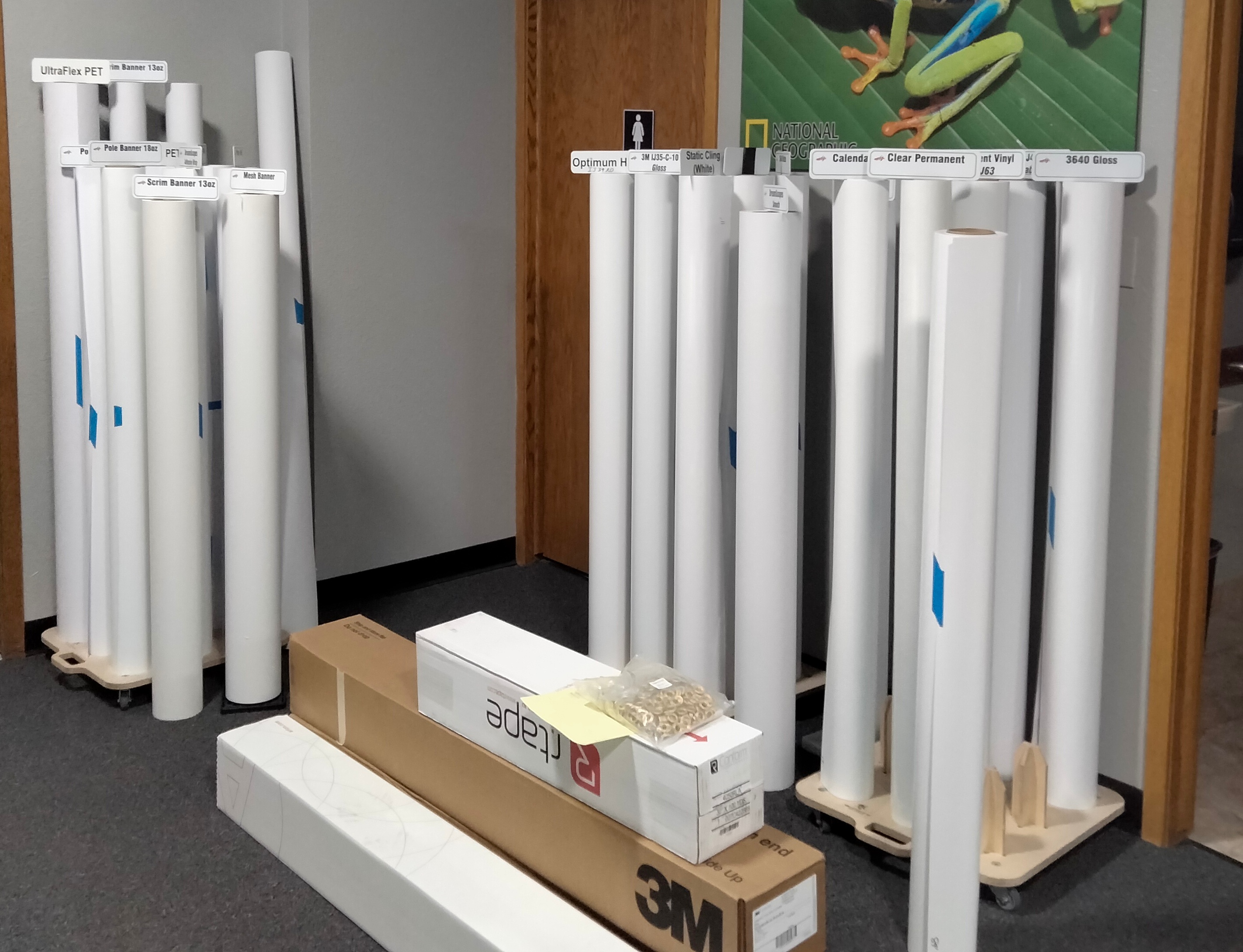

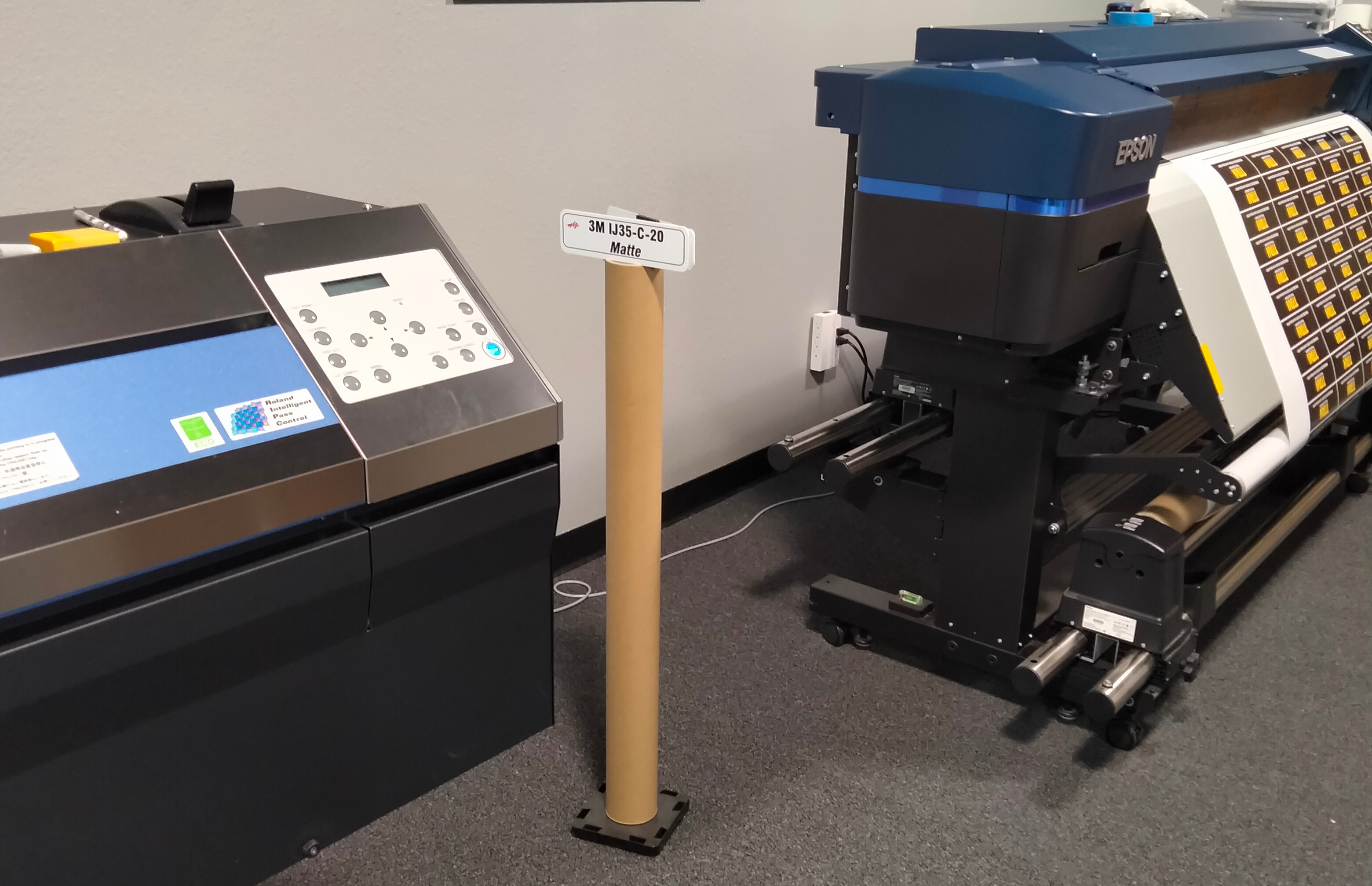

I have media markers. I made them with .060 HIPS about 6" x 2", with foam core or ultra board sticks. The markers sit in the appropriate media roll. When a roll is in the printer so I have a 38" banner core sitting between our two roll to roll printers, and the markers go in there when the media is loaded in the printer.
I've got the same system with laminate.
I sharpie mark the inside the core, put T-shaped coroplast labels on top the core (on most). I've got not dukes, so no excuse but absentmindedness from rushing, rushing, rushing.

Same. We cap all material with the plastic base they ship in, but labeled with the specific material. Not a lot of mistakes happening that way!

Yeah, but then when you're locked and loaded, ripped to the gills and ready to print, how do you double check what is in the printer without unloading it? Talk about a buzz kill!
Pics.
Ya look before you load it numbnuts. Are you supposed to look at the 5 tags sitting on the table that the peons forgot to put back in the cores to figure it out? As Johnny says, c'mon man.
You are supposed to have a tag holder on the printer that only holds one tag at a time. Makes people remember to do that.
