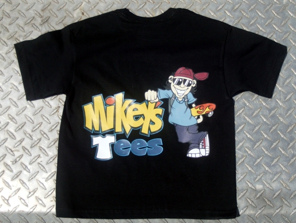

Try the Express Print from Stahls and I think you'll be amazed. Did some testing with it the other day and it looks just like screen printing...and on a black shirt. Super soft hand feel.
Mike
