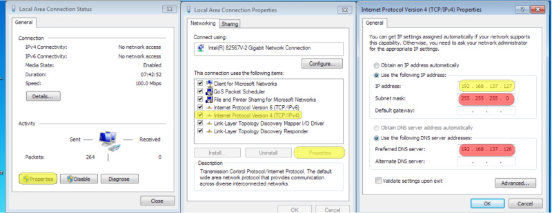

Open up your local networking status page
Select properties
Highlight Internet Protocol (v4)
Properties again
Select the "Use following IP address" radio button.
In the panel on the right from the attached pic:
The numbers in the 2 red boxes need to be read from the printer and
set to the same values you find there.
The yellow box needs to be set one number off in the last 3 digits from what your printer's IP is set to.
192.168.1.128 is what you posted. In the sample I set it to .127
Save these settings to update them.
Now see if you can ping the printer.
If you don't get a timeout this time then the printer can be seen by the network and you should be able to print from flexi after pointing it to the printer's IP address.
If this does not work just reset the radio button back to "Obtain IP address automatically" and the network will be back to normal.
