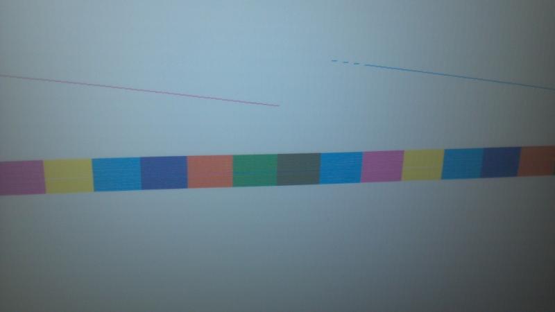

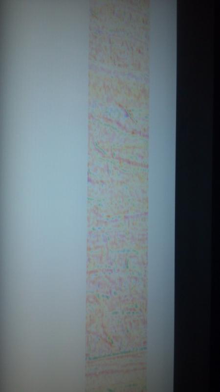

It seems that the black is not printing from the pictures after ripping
I have enclosed both a nozzle pattern check and what it is doing when I rip a picture and print
Like i said before , I am new to the Rip software , so any help would be greatly appreciated :thankyou:

here is the test sheet sent through Flexi 10
Do I have to send everything through Print editor first?
(sorry so many questions):thankyou:
