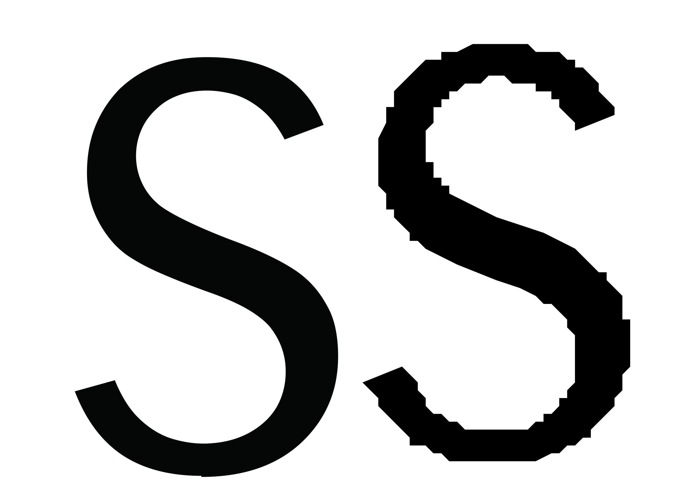

Ok, so I did a quick test. It doesn't support eps, but does support PDF and SVG. I converted a PLT file I had created as a test and it works, though the result is a lot more jagged than the original. I don't have a way to open a PLT on my computer, so I can't tell if it happened on conversion to or from that format. Attached is the S from the original SVG that was converted to PLT for my chinese laser engraver, then the one on the right is the result of converting the PLT to PDF or SVG. Astute Graphics' Vector First Aid works great for cleaning up files. It closed some open paths and it would reconnect line segments that touch but don't connect, but that wasn't the case in this example (but is in CAD files frequently).
Walt Netto

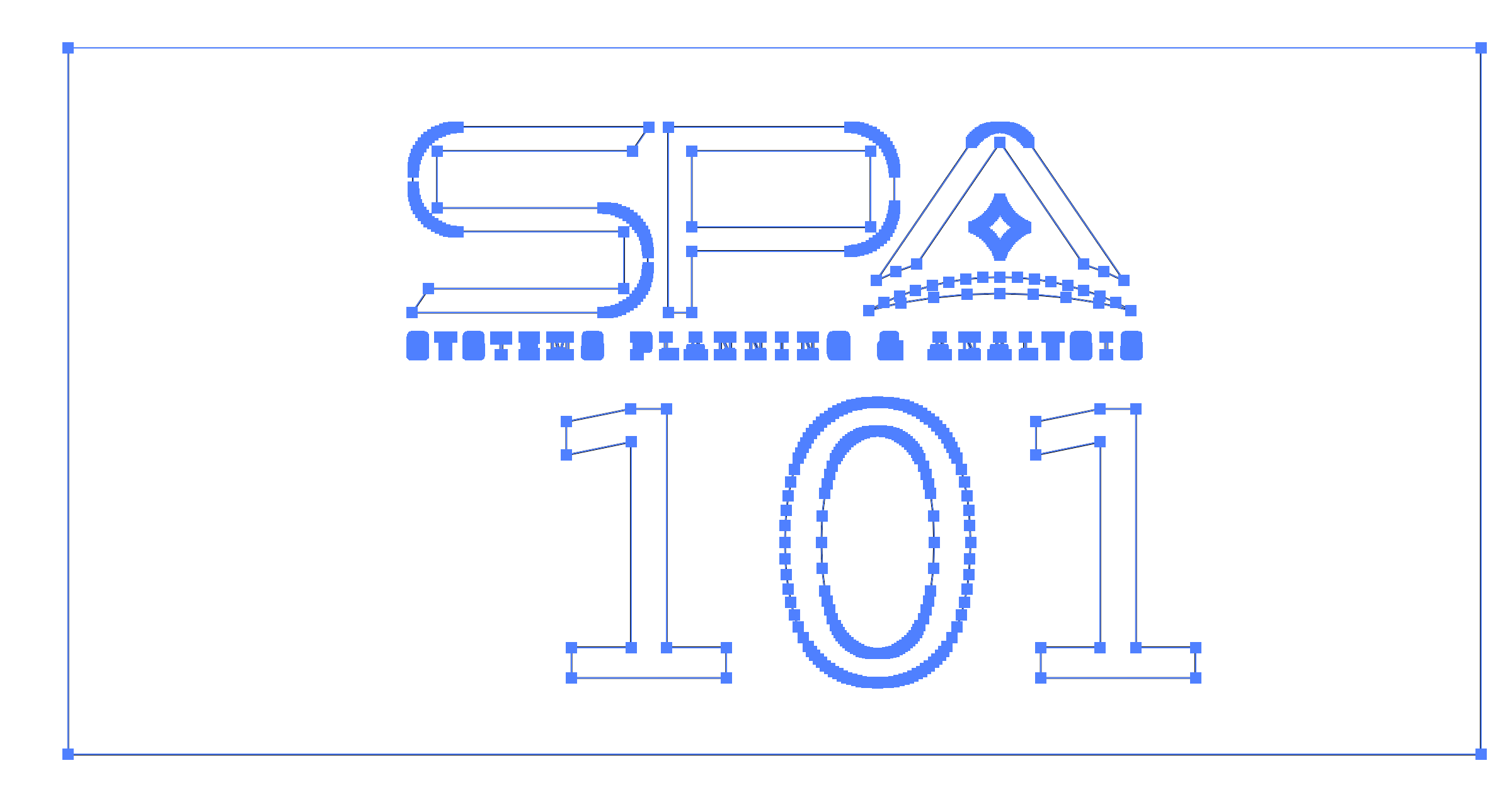

If you have Astute, you must have Adobe Illustrator. Could you please try opening your -- converted to .pdf from Uniconverter file -- in Illustrator, and see if it opens as vectors
and not an embedded bitmap. You may be on to something...
Walt Netto
It would appear you have stumbled onto something!! Just to be sure - you are referring to attached photo. $40/year but I can convert all my files in a couple of weekends...
