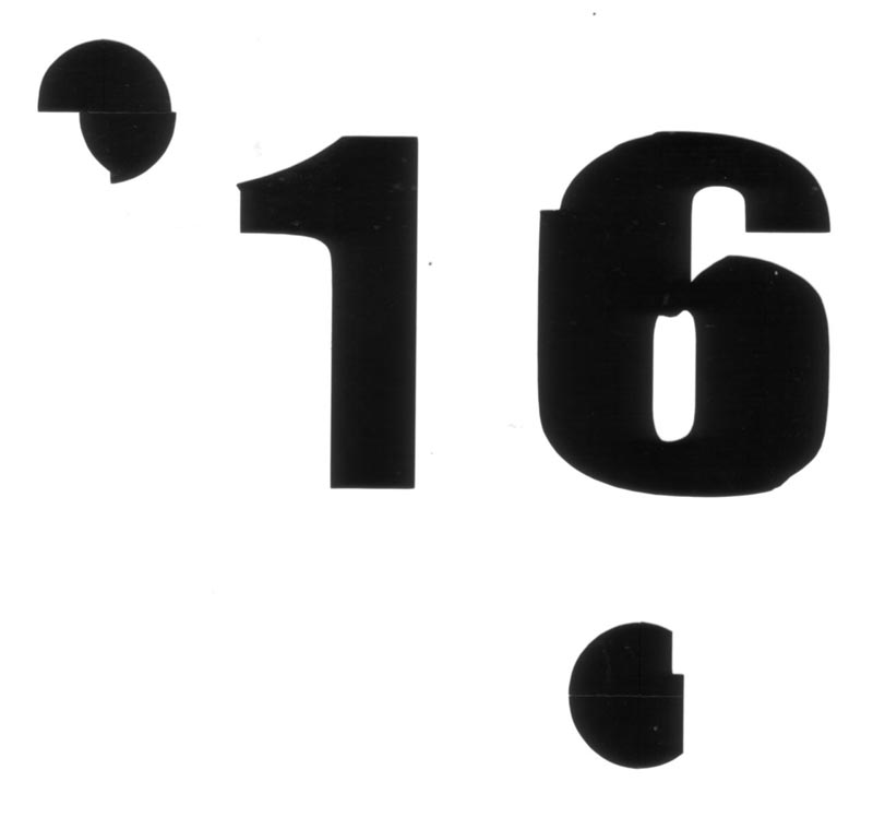

    I am getting a new Graphtec FC7000-75. But I found out today it is being held up in Jacksonville Fl; because of the hurricane damage. My production has come to a halt as a result. But in a way I feel very fortunate, because I still have a house, a family and business I look forward to going to everyday, I feel sorry for the people in in the Delta region who lost everything. I have jobs which are piling up. I have good customers who keep coming back, not because I am the best at what I do, but because they have been getting their signs from someone who delivers on time and won't BS them (No offense). I think that is important. My old plotter is a Roland PNC 1100 and I am having problems with it that I can not figure out. It doesn't close the letter all the way and is offset. Registration marks are off set. The first cut is fine but after a few minutes it starts to act up. If I cut a circle, the cut will not be complete and is offset. I replaced the nylon protection strip & still srewed up. I checked the carriage wire. I changed from a serial port to a parallel port. I repaced the printer cable to the p port. I still want to use Old Rol for back up. I give up. Help, I need to cut jobs, until my new baby gets here on the UPS truck.
    Attached is an example of the cut. I hope the image helps.

    Wow Not sure
    Don't know if this will help butt...
    My plotter ocasionaly does somthing similar...I manually clear the buffer and the problem goes away.

    Butt how do you clear the buffer on a Roland?

    When I upgraded???? to xp the only way to get my Roland to cut right was to put a usb to parallel cable between the computer and my roland junk. If you are running xp this may help. By the way it ran just fine on xp for months before it started acting up. This was Rolands tec support answer to the problem.

    You clear the buffer by turning your plotter off then back on. Sorry forgot that part of your post.
