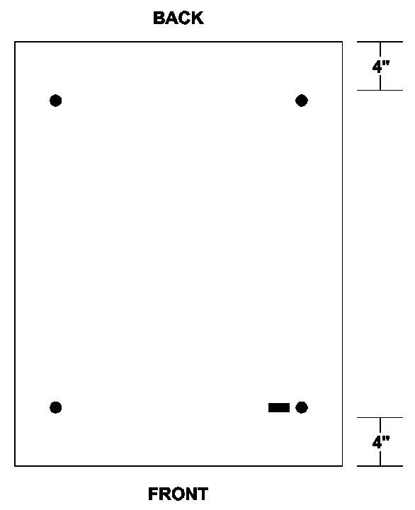

Not really following why you would add additional vinyl to the side, I think the 30" material would be sufficent for 25.8" image and crop marks. Here is a quick diagram showing what I was refering to, you need enough before and after front and rear crop marks in order to keep the media sensors covered. It's approx. 3"-4" on my SP-300V
if that's the case wouldn't just roll off the cutter? That's what mines does it there isn't sufficient room in front of or behind the crop marks. Sounds like it's not reading the crop marks.

I have 7" in front of the first 2 marks, and a little under a foot past the back 2 marks. I originally added the vinyl, as the right side top and bottom marks are somewhat close to the edge, but have since removed the added vinyl. Getting ready to do some coloring if this doesn't read this pass try - I like the idea Colorado gave, with masking tape - I'll try it if this pass doesn't work.
