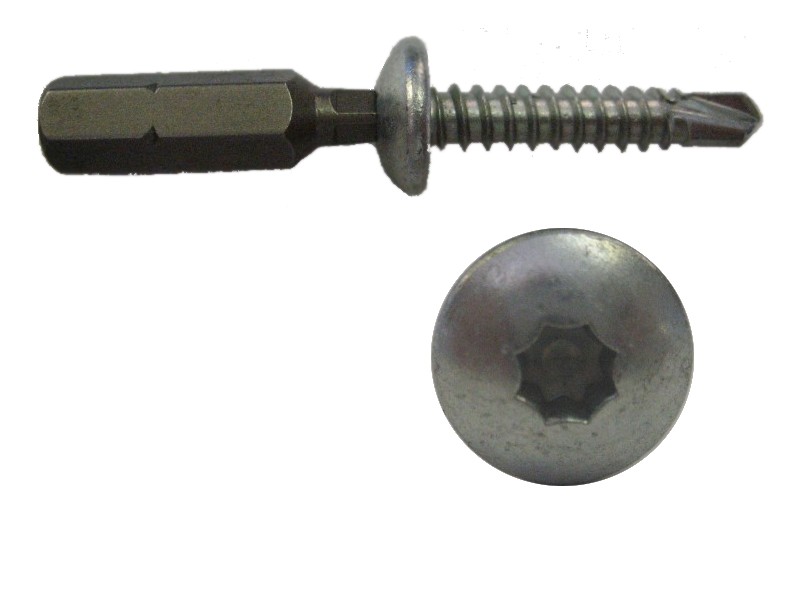

On most enclosed race car / landscaping type tag behind or 5th wheel type trailers the panels are attached with the kind of screws shown here. They are an 8 point screw that a #2 square bit will fit. I always remove these / apply the vinyl then reinstall the screws.
One tip is to remove all the screws in the area of the install / clean /start applying vinyl, after you finish applying an area reinstall the screws in that area to help stabilize the surrounding panels. Some trailer manufactures secure the panels to the frame (before screwing them) better than others.
Also, as a side note, if I'm involved early enough in the process of a customer getting a new trailer built, I suggest a screw-less option. It's not much of a cost increase, they look tons better without all the screws, and the customer will save money on your end because the vinyl install will be cheaper.
