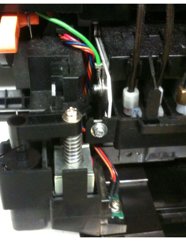

Well, after working on soaking the nozzle all day I finally have a clean nozzle check. I'm able to print, and I just went into the software and turned off the cutting option all together. Cutting the paper with scissors isn't all that bad, but I would still like a solution. Graphics One called and said it sounds like our cylinoid needs to be replaced?? I have no idea, if you could send a pic of where the blade is I will surely check it out myself. I tried looking, but I don't want to be poking around.

Here you go! It is black, I have a line pointing to it

OH MY GOD!!!!!!! Terry, you are the best! So someone had the little black piece that pushes the blade down swung out and was using it as a handle for moving the carriage!! Sooo dumb! Fixed in a second! Thank you!!!
