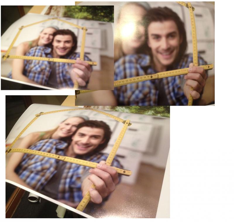

To me it looks like someone did some lousy editing in Photoshop or similar, I would do a full size partial crop of the image, print and show that
to your customer.
Have you seen the original downloaded image or is this it?

I was able to download the original photo from getty
I tried the settings under quality. No difference.
I did another profile just to be sure. No difference.
Downloaded Epson Overdrive RIP. No difference.
However it looks fine on the screen.
I did also try a printout to our Xerox 560 of the raw photo..It printed correctly.
It's leaning more to something with the Epson 9800..
Hmmmm

I have shown it to my client...
They don't like it either.

here are the results of my test print
the photo has the focus on the hand and the ruler and the background
including the faces are blurred which you get in a camera shoot with
shallow depth of field. In any case, my test print shows exactly whats in the photo.
i suspect that in your case, you might have printed in CMYK mode. try printing
using RGB files and that will solve it.

Did u get it to work. If not try printing in JPG or if in illustrator
make sure it's on RGB mode.
I tried it both from AI and of PS.
Same thing.
Made sure document was set to RGB. Set for no color correction.
The photo is a jpg.
What am I doing wrong?
