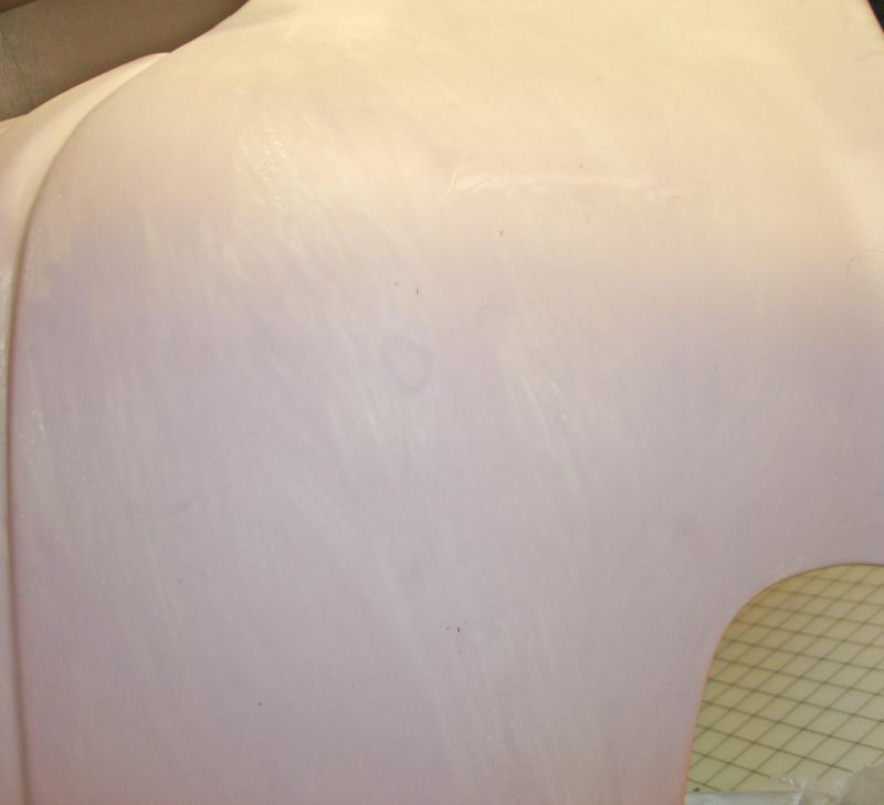

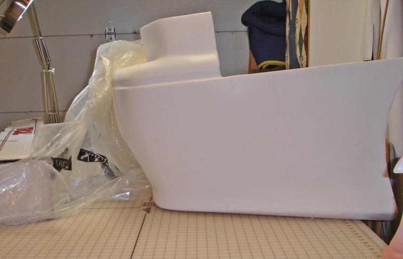

Brian, I took one photo that show a section from a distance and one close up with light behind it so you could kind of see it's make up. I can take one outside in the daylight in the morning if that would help.
Thanks, GG!!!

Looks to me like it it gel coated and probably sanded. I think they do this to get rid of the shine as to not see imperfections as easily. Pretty cheap kit, and they usually need quite a bit of work to make them right as far as fitment and straightness. I think I would definitely get them fitted & painted by a reputable bodyshop first. Of course we do also own a bodyshop so to me anything less than a perfect fit (which an amature usually cannot achieve) is unacceptable. Not trying to say your not capable, just take your time and prepare to get frustrated. A word of warning too, be careful when removing bolts, use some pb blaster to soak them first as them cheapo toyota bolts like snap off.

From the photos those look like they are gel coated! Have you tried to stick any vinyl on them?
I tired a piece of 3551 RA, and it stuck. And by "stuck" I mean is it didn't fall off, but it defiantly didn't have the bite it should and came off too easily. But that's without doing anything to the fiberglass yet, no decreaser or alcohol. I didn't want to start messing with it till I got some input from you guys.
