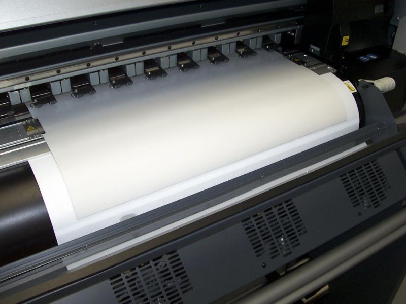

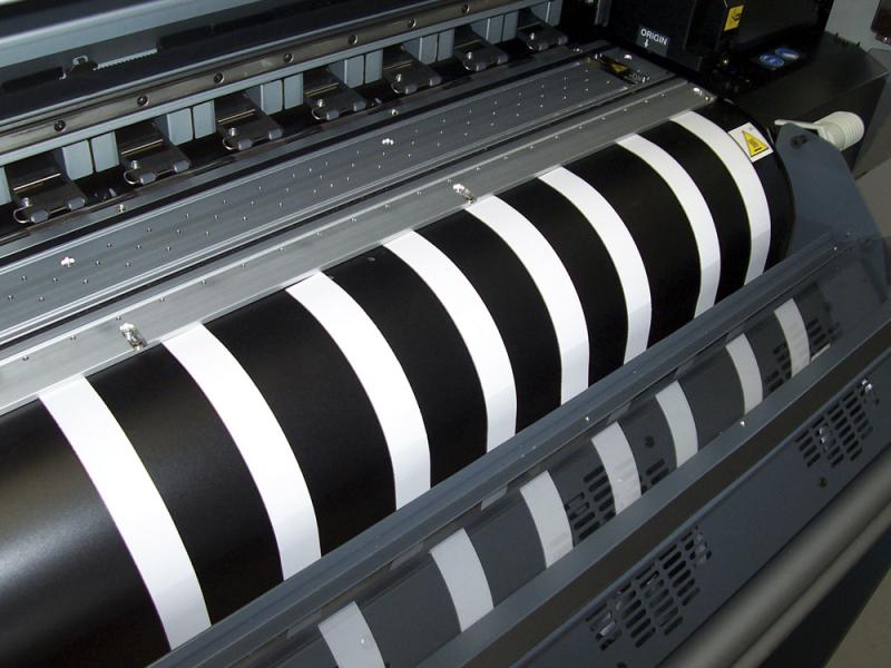

Here's what magnum magnetics sent me when I tried printing on their printable product. It did work but the product didn't look as good as printing on vinyl and then mounting.
Tips for Mimaki JV33 and JV5 printers to facilitate the printing of Magnum’s DigiMag® VINYL magnetic sheeting:
We suggest that feed adjust/bi-directional calibration adjustments be made before running the magnetic sheeting which is thicker and heavier than other materials you may be printing. To avoid frequent adjustments we upped the pass count 1 feed setting from 8 to 16 on our printer profiles so that the media will pulled forward in shorter increments and therefore will make it much easier to dial in and keep the feed consistent. The pass count can always be switched back to 8, but this may require that the feed be adjusted during printing.
• Cover the pre-heater and dryer so that the magnetic media can travel through the printers. Stick a strip of magnet to the printers covering the pre-heat and dryer areas so that the magnetic sheeting will travel through these areas without issue.
Printers with a metal platen, shell, etc. to which the magnet may be attracted: We recommend the creation of an air gap to facilitate printing on the magnet. For example, a .020" clear sheet of polycarbonate cut wider that the width of the magnetic sheeting and as long as required. Apply adhesive-backed magnetic strip to the polycarbonate sheet. This will allow the polycarbonate to be affixed easily to the printer and removed quickly when not required.
