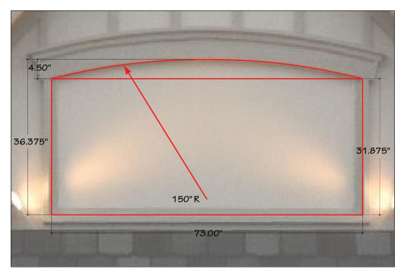

I am working on a sign for a building that was just renovated. They built this arch area for the sign into the front, and I'm just wanting to make sure that I'm thinking right so I don't have to redo this and be out lots of time and money.
I took the length of the two sides to the bottom of the arches, then I took the middle of the arch, and used the pen tool to connect the dots. Is it that simple? In my head there should be more to it, but I don't know what it would be. I'm going back to all of this geometry stuff in my head, but just not 100% the right way to confirm my arch is right. Can anyone help me to make sure, judging by these measurement?
Using your photo and dimensions, I created a full size drawing in Adobe Illustrator using the CADtools plpug-in for scale and dimensions, enlarged you photo for size verification (had to rotate it slightly to the left), then made the drawing on a separate layer over the photo. According to my drawing and calculations, the arch radius is 150 inches.

Template it, if your arch is not the same as theirs it will look like crap. The lighting for the sign needs to be addressed there is more light shining on the outside of the frame than inside that will lite up their sign, that will cause huge shadows along the signs edge.
TheSnowman
They already said that they hated the lights. That's just random lights the construction guys put in I assume. So those will be changed after we do this. What a mess it all is. I think Phototec hit it on the head...but just for peace of mind, I'm having my installer go build a template today. It's supposed to be decent weather, so hopefully he won't have any wind whipping through the street throwing his cardboard around.

There is zero substitute for measuring the actual opening.
The best thing to do, as a couple of others have stated, is measuring all the aspects of the opening (not just a couple of measurements and eye-balling the rest I've gotten that nonsense from a couple former co-workers).
Measure the width of the opening.
Measure the tallest point of the arch to the base of the opening.
Measure the height of the left and right ends of the opening.
Get height measurements at several points in between using even increments.
You'll get a pretty accurate V.O. measurement from this, especially if the builder used an even curve radius to develop the arch.
I strongly discourage the practice of scaling measurements from photographs alone. Distortion brought on through the effects of perspective, shooting angle and optical issues in the camera lens (barrel & pincushion distortion) make a photograph only close to scale and never truly accurate. You need accurate measurements of the visible opening.
