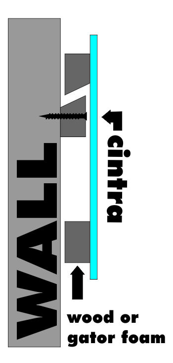

The way I mount them is the same I mount any of my masonite paintings in galleries or any sort of flat pieces. Follow the illustration as needed. you have 2 pieces attached to the cintra (that will also help lift it off the surface) ... the top piece has an angled cut that will correspond to the piece you mount to the wall (with 2 screws) if the piece is a little heavier or more prone to sliding off, I use wood as the backer so I can screw through the top piece into the piece it sits on (and able to unscrew for removal).

Tyrant,
That's called a French Cleat. We use them a lot. If you use a set of cleats top and bottom, instead of a spacer at the bottom, you have a panel that can't be lifted off. You slide the panel on from the side. Only works if there is enough space, obviously. Museums love this set up.

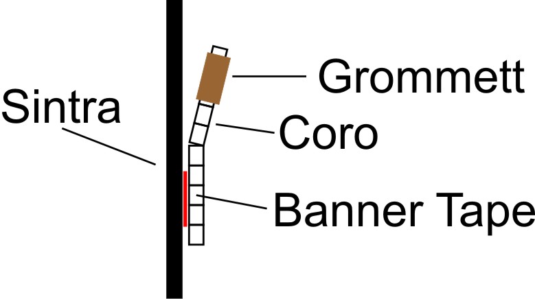

Farmboy
We just used a hanger like this for foam board signs that went in Tim Hortons and Arby's. Quick and used materials already on hand.

Been a long day, couldn't think of the name, thanks Donny. museums love them, I adore them. Easy to install in exactly the same place and straight if you have multiples, and you can do easy installs and removals especially if the customer needs it swapped out occasionally.
