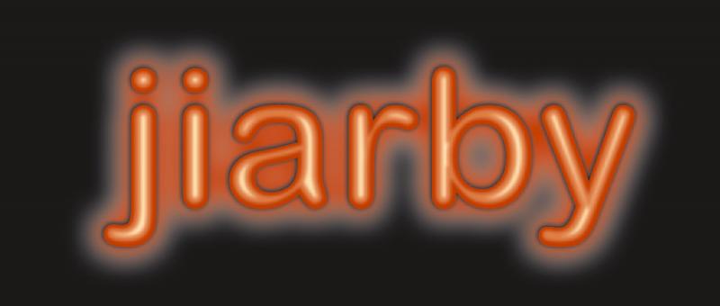

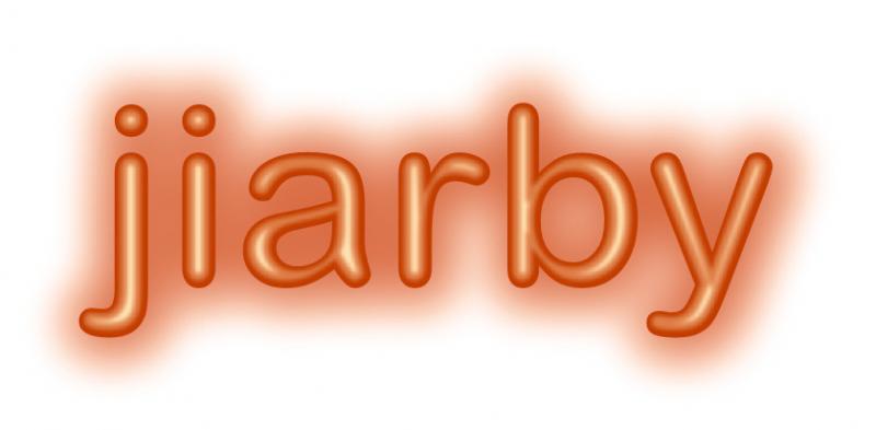

jiarby
This one is the contour, break apart, bitmap, then gaussian blur method....
