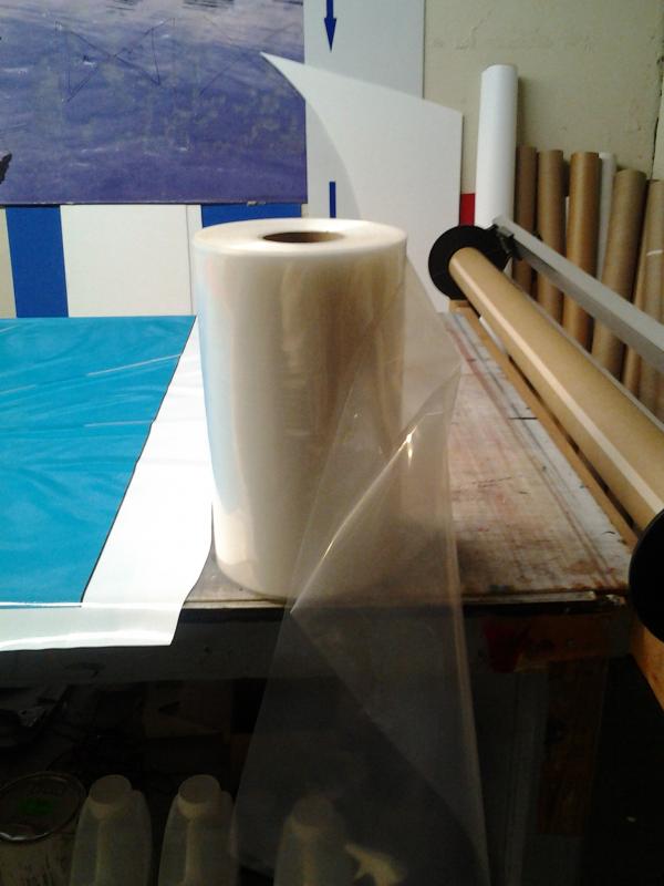

print side out, when using banner tape to hem the banner this works much better. as far as damaging the banner, we use this plastic tube like product from ULINE. cut off the length you need, put banner in, tuck each side into the end of the banner, and you have a nicely packaged banner.

We pack our banners pretty darn thoroughly for shipment. Roll them ON a 3in cardboard core...Print side in....paper or plastic dropcloth on the image area to protect them. Wrap them in scrap 13oz vinyl and then use the thick plastic tubing that darlak uses as a final touch. We ship a lot of banners around....clients sometimes complain about unwrapping for 10 minutes...lol... but when it comes down to it, the banners are NEVER damaged.
