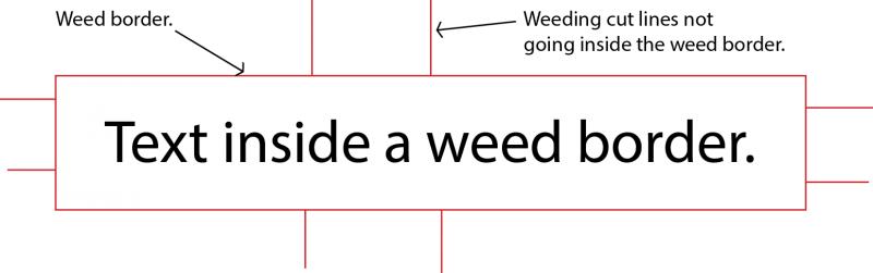

Well sort of...
A little off topic, but on the topic of weeding...
I found a DENTAL PICK (the little sharp stainless two sided tool thing a dentist pokes inbetween your teeth with) in a local auto parts store (go figure) a couple of weeks ago. These things are very sharp and very, very fine pointed. They work AMAZING for weeding anything... especially the tiny stuff left behind. Just though I'd share that tidbit! Next time you're at your dentist, ask him if he has any old ones he wants to sell cheap. They were $3 a the auto parts store!! :smile:
Guess I'm really stoopid today more than other days, but what are you all talking about ??
I've been doing this stuff with computers since they almost first came out and I don't know what a weed inside a text border means.
If it's not too much trouble, could someone offer up a diagram or picture of this problem. In almost 30 years of weeding, I've never come across this predicament, but then, maybe we've always called it something else. :thankyou:
Tim Aucoin
First... here:
:bushmill:
Now... I think this is what is being talked about. All I know is the dental pick thing is amazing! :Big Laugh
