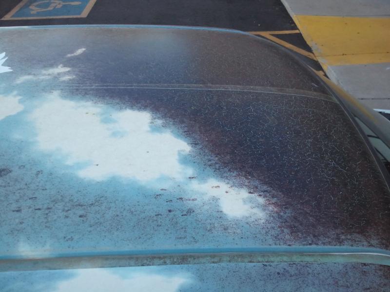

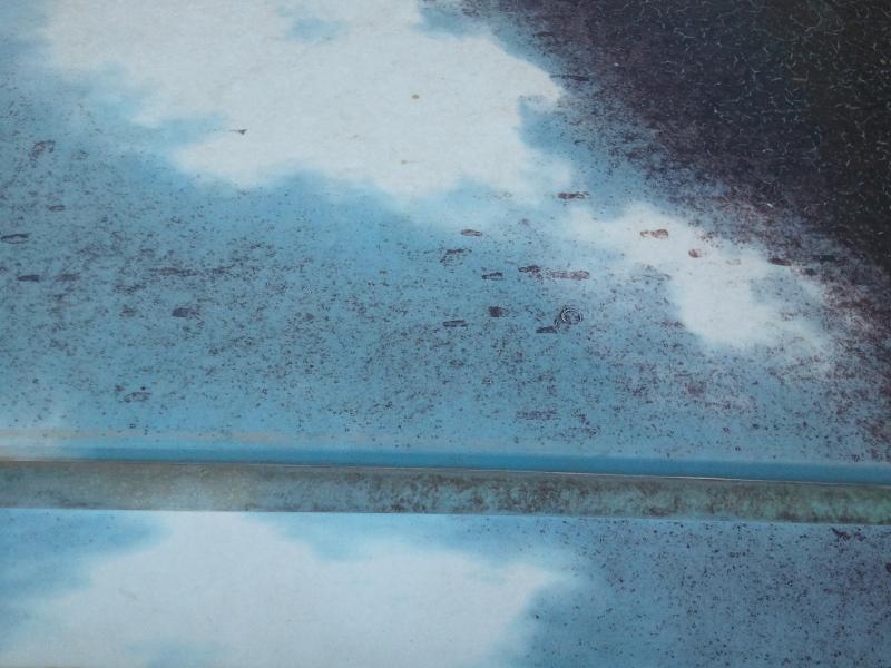

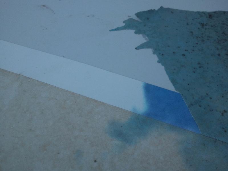

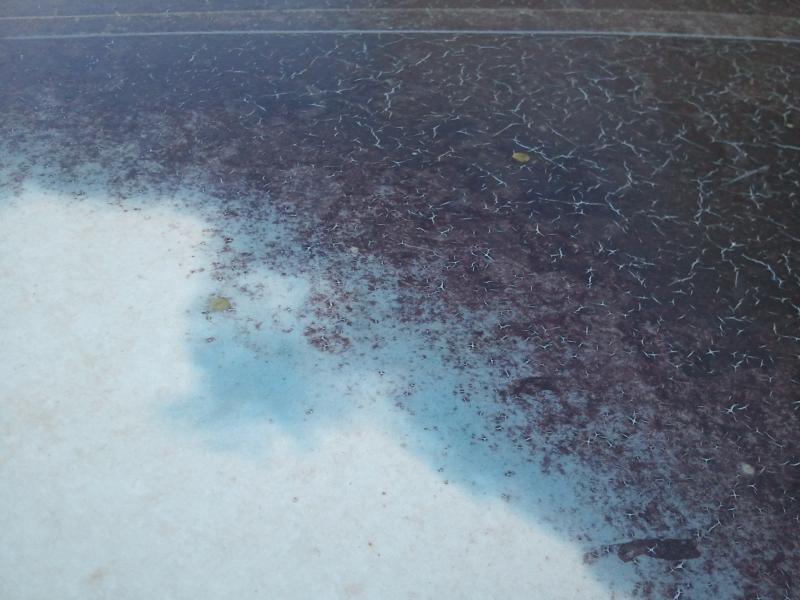

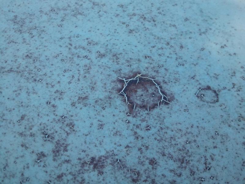

This appears to be a similar issue, although the vinyl is just over a year old.
Arlon 6000XRP with their 3220 gloss lam. Keep in mind the entire roof used to be a blue sky with clouds. No black in there at all. The vinyl itself isn't cracked at all, just the laminate. Not sure if vinyl itself is discolored, didn't think to check if I could peel off any of the laminate. it's still in the trash can at the shop, I'll have to check it out. You can see in one of the pictures what it "used" to look like, where I peeled off the vinyl over the seam.

Why I still get work, paint does not do that.
Seen this also a sign up the street one side browned out in less then 2 years other side looks fine except faded after 4 years and the good side is sun all day. maybe moisture has something to do with it.
