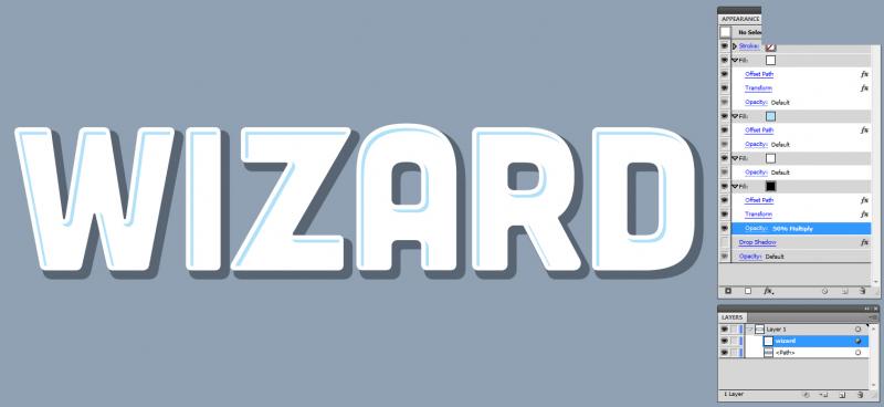

In illustrator, once you create a style in the appearance panel you can save it as a Graphic Style, then apply it to other objects by selecting them and clicking on the style in the Graphic Styles panel. It's a bit simpler than actions, it's akin to "copy layer style / paste layer style" in photoshop.
WI
In illustrator, you can also do it "non-destructively" by creating another fill in the style layers, offsetting the stroke inside, duplicating the fill and adding a transform moving it... change the color of the shadowfill then just save this graphic style and apply it over and over and over and over....

Once you've created your style it will appear in the Layers and Appearance panels like this.. You see it's still only one object in the Layers panel, and then all the other attributes are in the appearance panel. This is great for any printing work and keeps you organized, but no good for cut vinyl and the layers it creates on export aren't always pretty.

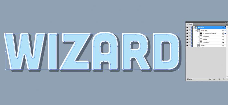

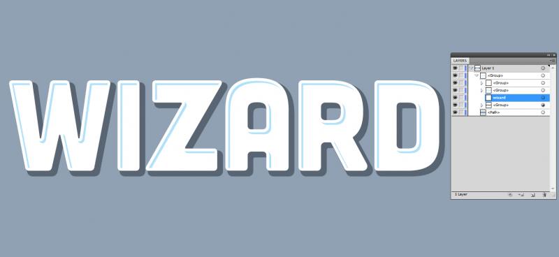

If we want to simplify this down to the most minimal object we can, it takes a few steps. First we EXPAND the object (With the object select, go to the Object Menu and click the Expand option). Your appearance panel has been set back to normal but you now have some new groups in your layers panel.
You need to remove the top white layer from the middle inner shadow layer in order. The simplest way is to first make each group a compound path... Select the group and hit CTRL+8 (or Object > Compound Path > Make). Notice that once it became a compound object it went transparent (it lost its appearance). Make sure to create a swatch so you can quickly reapply its color.

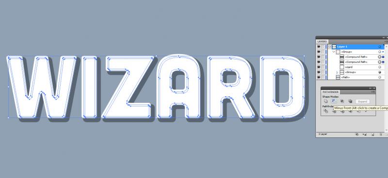

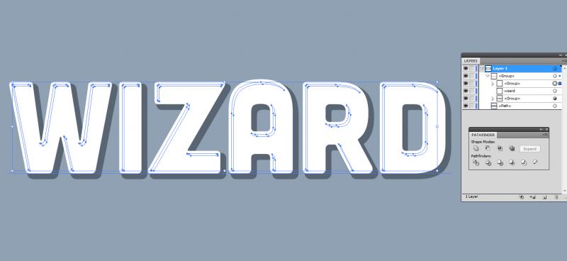

After both of these groups have been turned in to compound paths, we will use the Pathfinder tool to "remove" the top layer from the bottom layer.

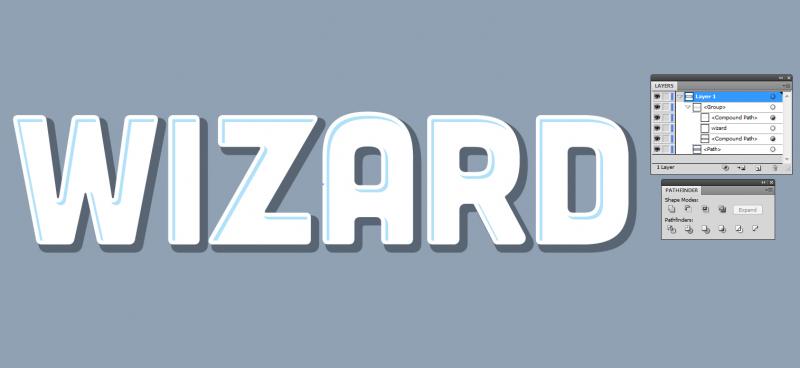

Now that you've subtracted the top layer from the one below, you end up with just those inner shadows we were looking for, but they are a group..
I like to keep my layers as simple as possible.. I've turned all four layers that make up the word in to compound paths, and reapplied color if they dropped their styles. We went from several complicated groups to just three compound paths. One for the inner shadow, one for the white text, and one for the drop shadow.
