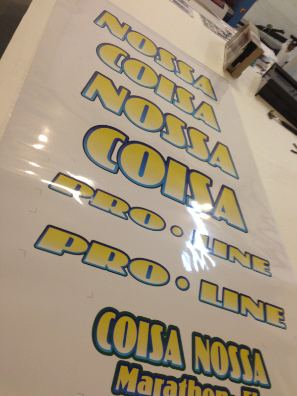

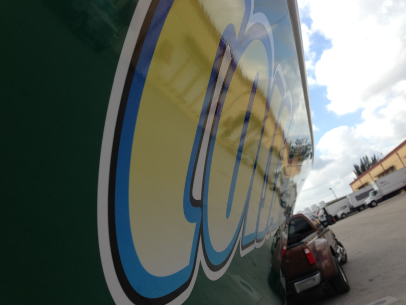

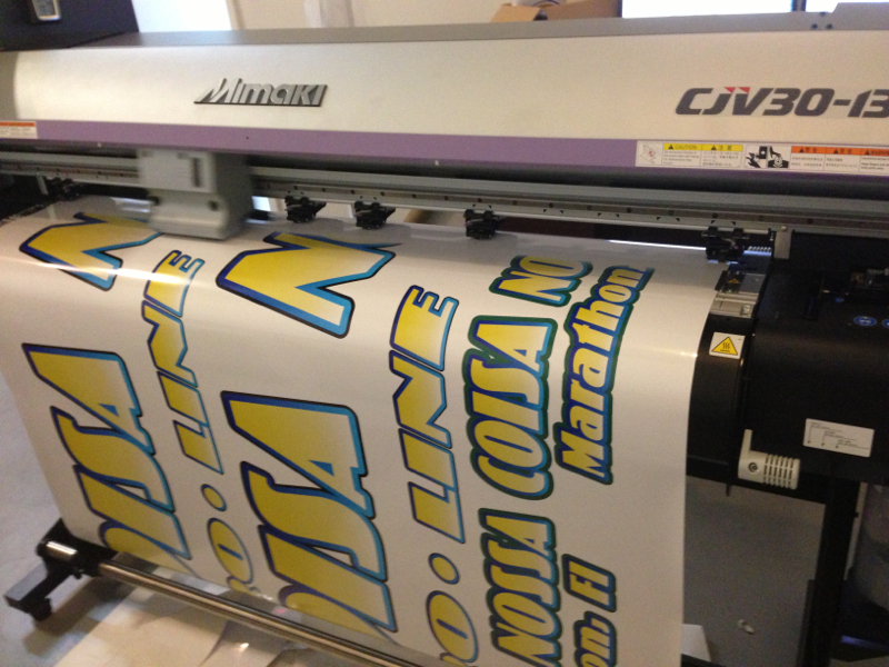

Here are some pics from earlier today

ironchef
First pic is the first set i printed with only one set of reggy marks, second pic is what i reprinted with each word having its iwn set or reggy marks
