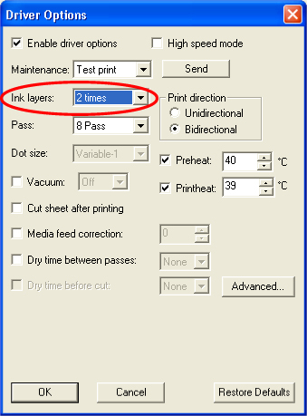

It is called Ink Layers in my version Flexi.
RIP and Print>Advanced>Driver Options>Ink Layers
This is for a Mimaki JV3 setup, though. As previously noted, the RIP options and nomenclature vary according to the printer setup.
