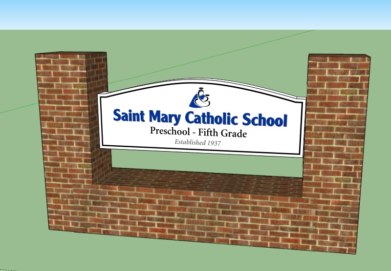

Hey I'm wondering how to install this sign between brick posts. (The picture has stand-in posts - the actual ones aren't gonna be that ugly!)
I'm making the sign with alupanel faces and returns.

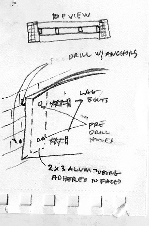

Presuming you have a frame, just use anchor bolts directly into the brickwork. Fit the rear panel of the sign after mounting, so no fasteners are visible.
Billct2
If you can design it so one face can be removable you can fasten thru the sides of the cabinet.
If not then you'll probably need some brackets, two on the bottom and two on the top would be least conspicuous and paint to match cabinet and the brick
