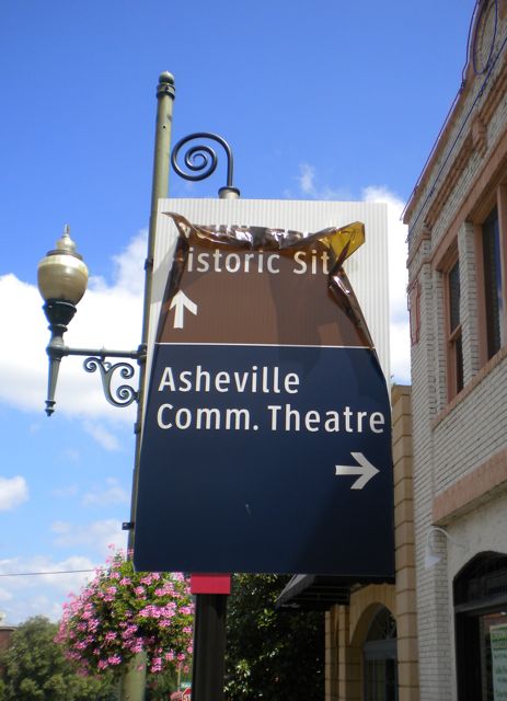

Aside from coro being a ridiculous substrate choice for a job like that what on earth could they have prepped it with to make it fail like that
Calendared vinyl applied using a laminator using way too much tension.
FS-Keith
Do you guys think for some reason that the signs for the ashville job where coro? They were def aluminum. Just applied incorrectly as this thread is all about.
CES020
You can see the ribs in the coro, can't you?
This looks like coro to me, but I guess it could be aluminum with that pattern to it, but that would be a new one on me.
FS-Keith
what you think is coro flutes is actually the base prismatic vinyl. they sheeted them with white first and its the second application of vinyl they did over that, and thats what failed. That company makes junk signs but they are not that stupid.
CES020
Good call Keith! It fooled a number of us. Now that you said that, I can totally see it. Thanks for clearing that up!

    I find this all quite absurd. We messed up here in Ashville by making someone use something they told us wouldn’t work… and when it didnt work(like they said it wouldnt) we blamed them. Now i know it’s hard to admit when you’re wrong but we dropped the ball. TIme to admit it…"
    Why did the signs peel? Can nothing go over prismatic reflective?
