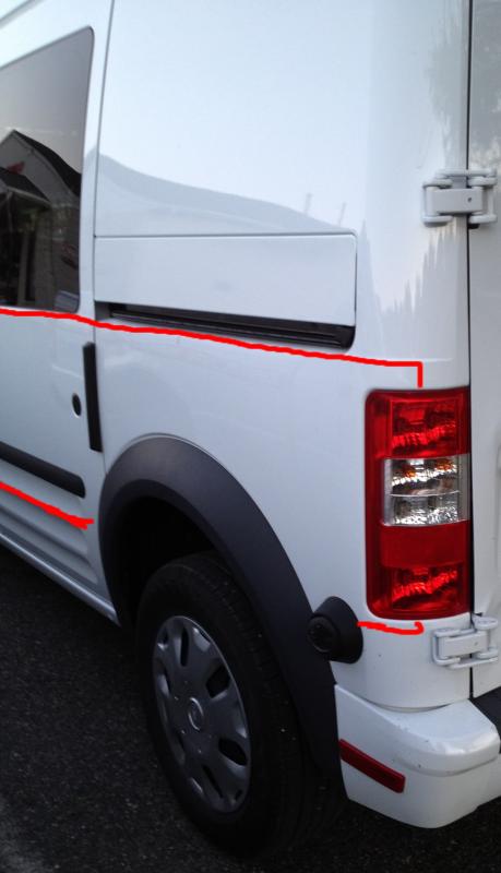

Hey guys, I have a potential install to do on a new Ford Transit Connect.
The install is simple other than this stripe that goes on the side and wraps around the tailgate. It is just below the slider for the door. The side molding and flare have me a bit worried as i want to do a nice install.
What would the best way to go about installing this stripe be? Stripe is 6'x1.25'
Top hinge, Side hinge, wet lay?
Thanks!

no, you don't install wraps wet for the love of god.
I didn't really think this was considered a wrap, I honestly have no idea what material will be used as the company is sending me the graphics to install.
jfiscus
Rap Master
Install the rear panel with a vertical hinge around the door edge area, then lay the top& rear edge area on the door first, slit the door jamb like regular, lightly lift the bottom area back up, install down to the molding, cut around the molding top edge & rear edge slowly as you install it a bit more, then install the bottom area under the molding.
OlsonSigns601
I would say a 6' x 1' 4" sheet would be close enough to be a wrap.
Stripe would be small like 6" x 1 1/4"
This would be the perfect job to get a little wrap experience if you have none.
I would say you could use 751 but then you won't get the wrap experience using something with Air Release and less tack.
ProWraps
has nothing to do with it being a wrap. it has to do with the type of material/s used. grey adhesive material should never be installed wet.

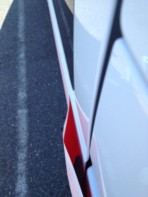

:banghead: The mock up photo didn't include these things that are now in the way.
Any idea how these come off and how easily? (door trim part and circle piece)

HulkSmash
Thanks!
what's the issue? Install over the trim, and then trim it out.. much easier then ripping it off...
Circle part most likely won't come off.. just install around it, and come back in the end, and press it close, then trim.
For this one i'd horizontal hinge.. and install up and down rather from the middle out...(left to right)

If the circle part (door holder magnet) is like on the Sprinters you just grab the entire thing and unscrew it, on for the part on the sides, to remove the other half on the doors you have to remove the door panels inside to access a nut. Never tried removing one on a transit myself.

The photo is a birds eye type shot of the masked stripe laying over the hard plastic piece on the door.
