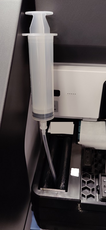

Out of Interest, how are you draining the ink from the maintenance cart? - Like yourselves, we're burning through them like no-ones business.

It would be even easier with a long rigid tube like a needle. Just stick it down there and suck.

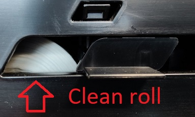

Always make sure you still have some fresh roll left in the cartridge. Also make that patch white and make sure the rollers spin freely.
