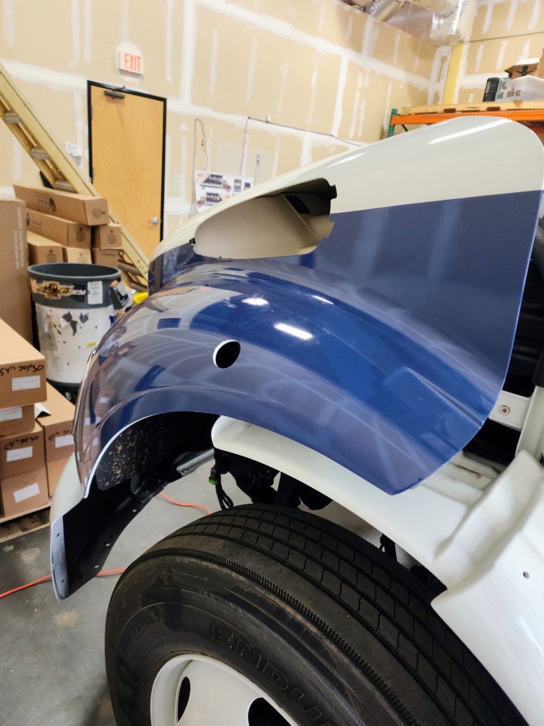

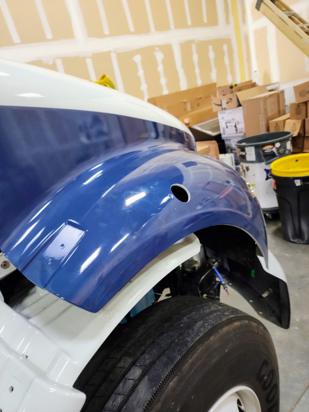

. From my experience so far there are two things where the 1650 fails compared to the Latex 800. 1. It can't print good black. By good black I mean dark, dense, pitch black. 2. The ink is supposed to withstand 80% strech but it can't. It cracks. However it is amazing how much it does sterch for a UV ink. So unless you print a lot of car wrap vinyls, as we do, you should not worry about No2.
