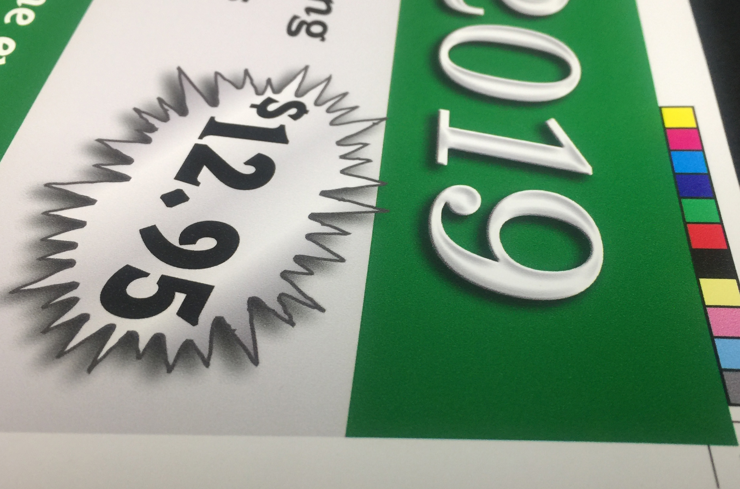

This photo shows about what you can expect with 12pass, black start at 30 and GCR at 100. For even less grainy look I have one that I use at 18pass with black start at 30 and GCR at 60 but this job didn't need that, but for small decals that one would be the one I use.
