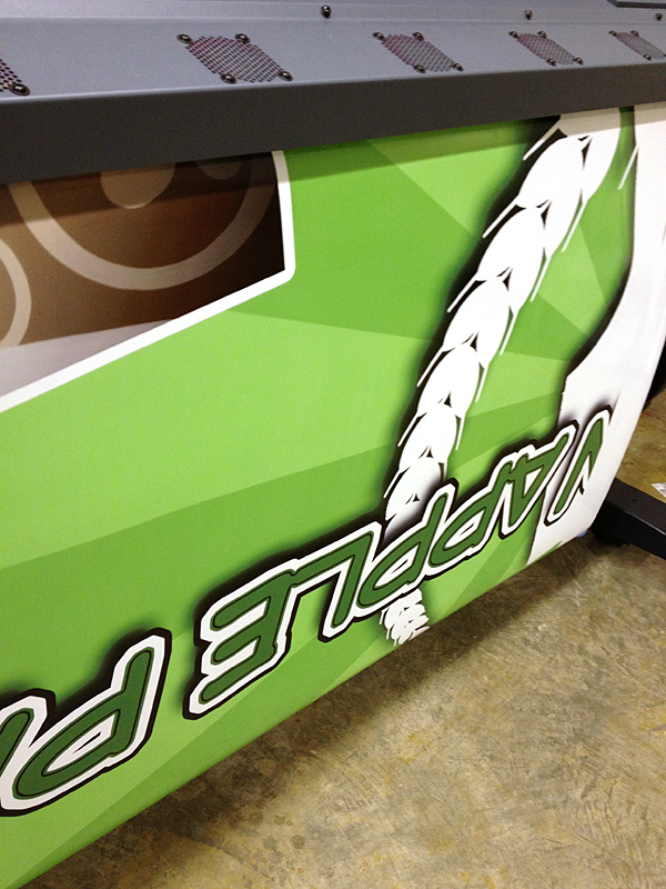

So, here is the verdict. I spent some time, and now can print and entire van in 2 hours down from 4.75 hours. I am printing in 8pass with very acceptable results, and I am super picky.
20 minutes to laminate the whole thing, and wrap ready in under 3 hours.
Thanks for the suggestion Colorado.
jkdbjj
This is what's coming off now, and it looks a little grainier then 12 pass, but only to those that have seen the 12 pass. I showed the customer and he loved it.
Awesome win/win for everyone.
