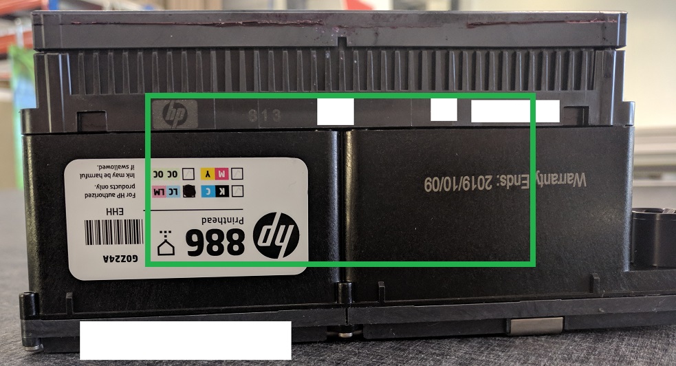

Thanks very much. I deduced that the yellow/magenta printhead has dried up. It has done only 4830 ml. Please is there a way to unblock the nozzles?I have already done lots of hard cleaning but it is still not unblocking it.

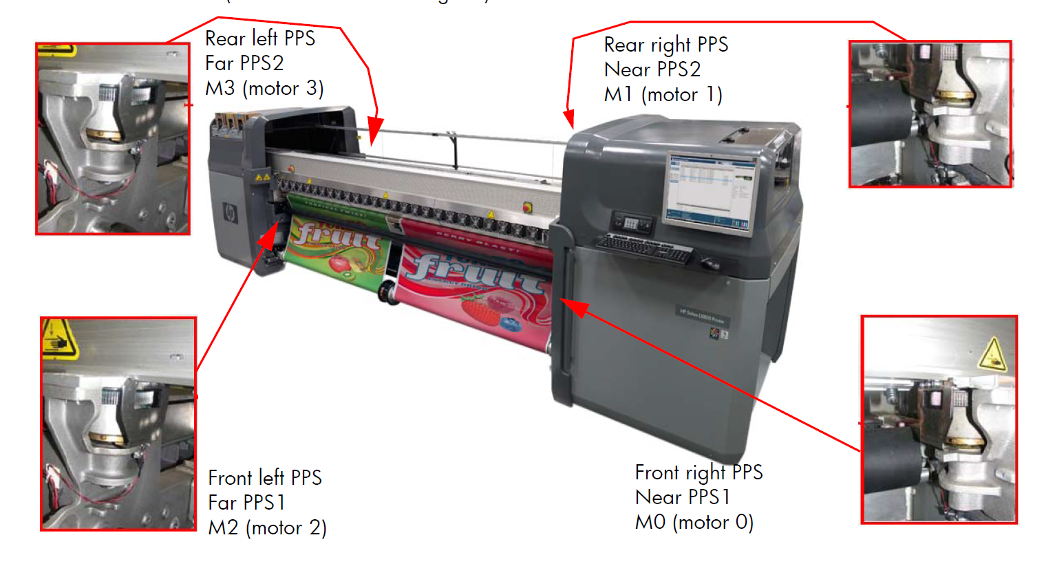

Hi it is asking me in Diagnostic menu to switch of PPS homing switch front left and it is beeping but I can’t locate it in the service manual nor on the printer.I will appreciate your kind support as always

As usual, all this info is in the manual... If you are really thinking about using this machine I recommend you to browse it and the user guide as well.
48.4.5:11= Front Left PPS. It's from the output side, ink side.
The sensor is in this picture, where the wires go.
sacristo
