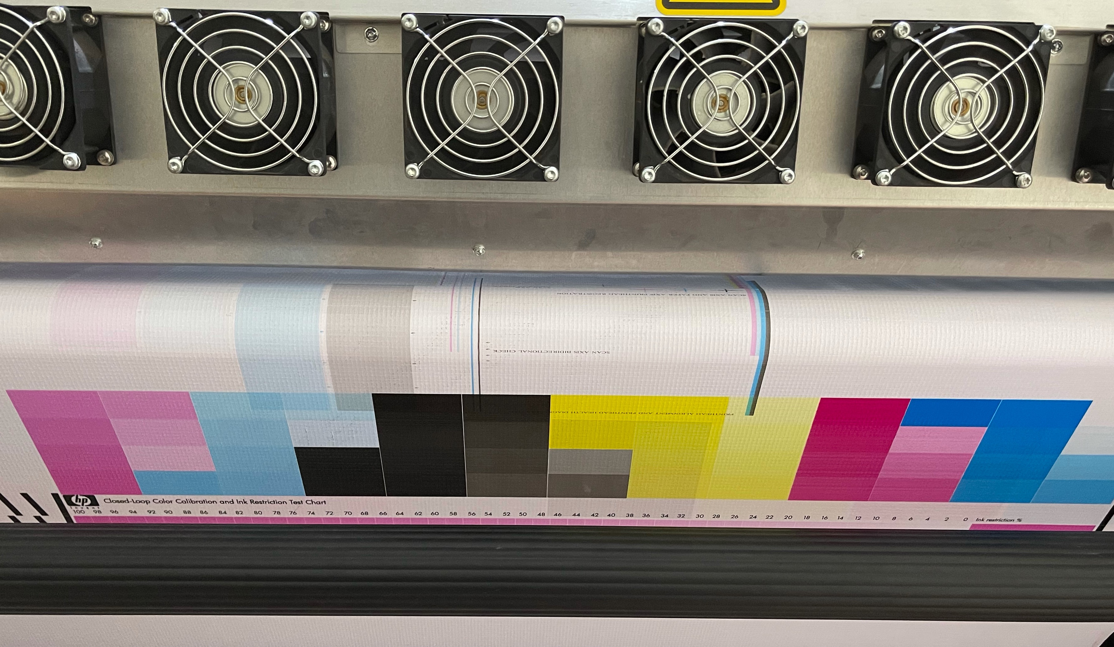

Thanks . All sorted out. A cable was actually disconnected. Reconnected and now all good.
