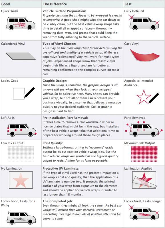

I thought about tweaking this "about 20%" and hanging it in our showroom

Link works for me, but my AVG blocked the page from completely loading, citing a threat called something like "Blackhole" ...

... Weird... If you google image search for good vehicle wrap, the image will come up, and you can visit the site that way... Maybe.
