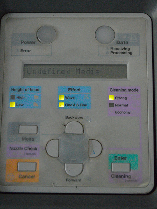

I have problem with my Mutoh 1604
nganoka386
Can you help me with this problem guys? It's been almost 3 months that I have this problem. Would you like to help me with this problem guys ?
guitarguy69
Their is an optical eye in the middle of the machine that needs to be covered up by media. If the media does not cover it it will give that message, ie media that is too far towards the right looking at the machine, thus not covering the eye. Could you tell me the width of materials used when the error occurs and also where does the error happen. The carriage goes to center, then to the right edge, then to the left edge to obtain the media widths then displays in metric on the screen. Let me know when the carriage quits the media width process.
If this is not the issue their is an adjustment for the eye on the carriage to help it see more difference between the material and material hold down plates. If the material used is a dark color I have successfully used a piece of white paper put between dark material and the hold down to allow the eye to read the widths.
nganoka386
The main problem is the printer is locked and the printer can't process printing jobs. Until now I don't have any Authorization Code to unlock this printer. Is there another way to solve this problem?
henryp
You may have 2 unrelated problems, although I'm not sure why you require an Authorization Code. (VJ-1604's do not require any unless you want to bypass the ink cartridge smart card)
A) Your printer will not print because it is in an error condition (Undefined Media). It seems like the paper edge sensor on the printer is not working (not sensing the width of your media). You can try bypassing this sensor by going to the user setup menu and changing the media detection setting to "OFF" and see if the printer will go online (Ready to Print), if it does, you should now be able to print.

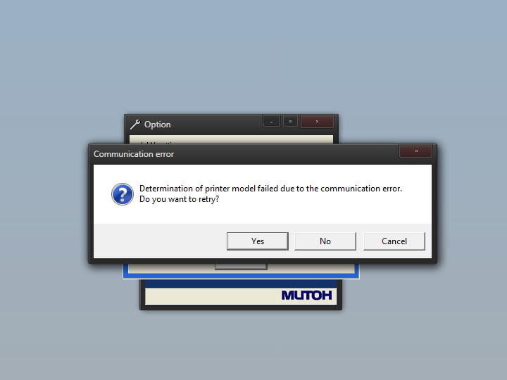

B) If you want to run the MSA program, you need to configure the MSA setup to match the printer's IP Address, then set a static IP Address on your computer close to this IP Address. I normally use the default setting on the printer's "Board Manager Mode" (192.168.001.253) then set the computer's IP Address to 192.168.001.250, also make sure Windows firewall on the computer is set to "OFF"

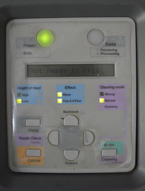

Sir Can I have the full guide of your (A) Solution? I turn off the Media Init. and the problem is this. Please show the picture below
try to access the serial number on the parameter by entering in the maintenance mode, check if its the same as the sticker attched outside your casing at the back near the mainboard box, does your printer comes in stock, or you alter in your parameter or firmware?
nganoka386
I'm done trying that process sir but still got error. And the error says "Not Ready to Print".
