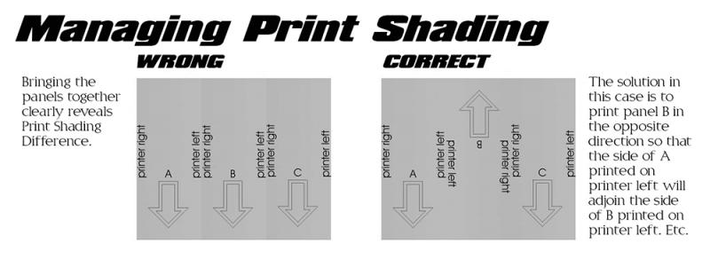

As you mentioned, sometimes you see a difference between panels (Print Shading), however in my experience it's NOT caused by sending separate panel to the rip, it has more to do about the difference in the printer from one side to the other, heater temperature difference from one side to the other, printing alignment due to wear on one side vs the other, like most small jobs are printed on the print head dock side, so more wear on that side.
When I print very large display graphics, I always rotate every other panel by 180°, so the sides of two panels that but each other and need to match perfectly, are both printed on the same side of the printer (lets say the right side). So half of the panels are printed right side up and the half are printed upside down (every other panel), that way you get the BEST tonal match possible.
Large professional display graphic companies do this all the time, we had a company print a very large display graphic of a Dell computer for a trade show and they taught me this trick, it's the ONLY way to get the Print Shading to match perfect from one panel to the other.
See attached Print Shading Guide (PDF) below, it explains this technique very well.
:thumb:

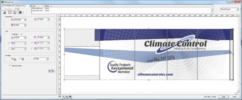

Eek!! In this case I'd probably print a 1.5" wide strip for each overlap so it provides a 3/4" overlap for the left and right panels. Certainly not the ideal solution but would save a ton of material and to avoid having seams facing forward you would apply the rear panel, then a strip, then the next panel, etc... Although 3 panels for the side of an extended full size van says something is very wrong to begin with - if that's the case then its probably going to be a full on reprint and a nice pile of wasted material and time down the drain.
For what its worth Flexisigns paneling is near foolproof and really makes things simple. We always use a 3/4" overlap and that is what you set it for. In the paneling screen you can drag the panels lines about to put the overlaps where you want them, you can click a box that will just auto-panel the side in all exact same width panels, you can select the panels individually and tell them to print or not print individually, you can drag new panel lines both vertically and horizontally and even a combination of both (for example you can drag a horizontal panel line over what would be above the front fender then select not to print that big section since it is not needed). Also in Flexi - on another screen is a checkbox for automatic tile flip which inverts every other panel when printing. This is what makes sure the overlaps both are printed on the same side of the printer. You can also select to print a small numbered tile map. This shot shows how Flexi does it - an example side wrap for a short NV - notice the far left has 2 sections paneled and crosshatched (the crosshatching means I've deselected those to not print).
I now it's not really helpful for your scenario but it shows at least how Flexi deals with paneling (its very flexible) and tile flipping for printing to avoid color shifting at panel seams.
